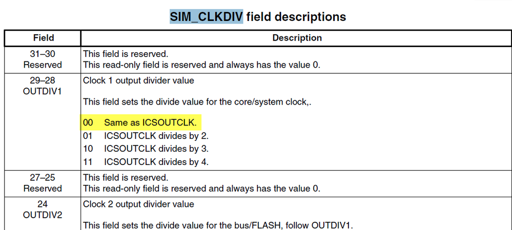

we can use FEI mode to generate 24M bus clock.
with 37.5khz internal clock, ICSOUT can generate 48Mhz output. ICSOUT=37.5k*1280=48Mhz
according to below clock diagram, we can set DIV1 as 1 to divide ICSOUT by 2, thus generated system/core clock is 48/2=24Mhz
thus we can set SIM_CLKDIV=0x11100000.
with above code, system/core clock is 48/2=24Mhz, bus clock=48/2/2=12Mhz. I made a demo under KDS3.0. see attached.

ZhangJennie
Hi Vignesh,
in my first response, I set system/core clock by setting DIV1 in SIM module
your code sets system/core clock by setting BDIV in ICS module.
Carlos is correct, you can only remove ICS_C3= 0x90; to get 24M core clock if don't consider clock Trim.
with your code, in FEI mode, FLL output 37.5k*1280=48Mhz
with this code:
ICS_C2|=ICS_C2_BDIV(1)  ; // BDIV=divide by 2
ICSOUTCLK = FLL output/2 = 48/2=24Mhz
thus with default SIM_CLKDIV value: DIV1=00, we can get system/core clock = ICSOUTCLK = 24Mhz
can this help you?
