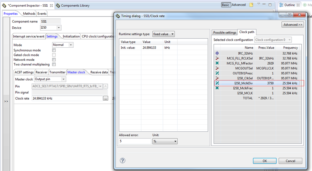

tomwood
I am trying to set up the I2S signals with processor expert using the SSI_LDD .  I don't seem to be able to get the bit clock and master clock to be in an 8:1 ratio.  The master clock seems to always include a divide by 250 in the divider chain and the bit clock does not.  I have tried various frequencies but they always have the divide by 250 in the chain. Other ratios are acceptable such as 16:1 and 12:1. In the I2S0_MclkDiv line of the clock path tab of the Master Clock, Clock rate select button there appears to be a 256 divide option but I can't seem to select it.

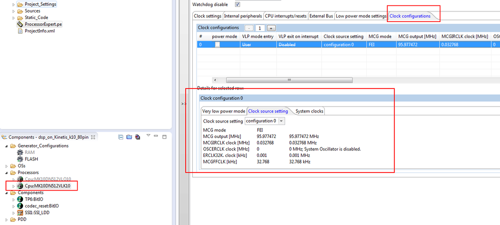

(2) How to configure the clock  ? first we need configure the CPU clock :
then , refer to your demand calculate the Clock rate of I2S, then choose it on clock rate.

tomwood
If I pick 1.4996 Mhz as the bit clock which is an exact power of 2 down from the 95.997 then the bit clock divides by 2 and then 32. Using 11.997 for the master should be attainable as an exact power of 2 division. PE however chooses to first divide by 250 then x 30 . rather than 256 and 32. This gives 11.517 mhz instead of 11.997.

tomwood
I believe I attached a project already. I am using the MK10DN512VLK10. If you try to enter 11.997 for the master clock which is an exact power of 2 down from 95.977 it chooses to divide by 250 instead of 256. I have attached the spec sheet for the codec that I am interfacing to. See the table on page 9. If I try 12.288 for the mclk it chooses to divide by 250 and multiply by 31 to give me 11.901 instead of multiplying by 32 and giving me 12.28512. If I choose 1.536 for the bit clock it chooses 1.6 Mhz when it could have divided by 250 and multiplied by 4 to give me the correct frequency.

tomwood
The receive clock and the master clock must be in an exact 1:8 ratio. If I set the master clock to 12.288 Mhz then it gives me 11.901 Mhz. It is actually 11.901148 (95.977/250*31). So I must then have a receive clock of 11.901 divided by 8 which would be 1.487625 or more precisely 1.4876435 (11.901148/8). The receive clock generated is 1.500 Mhz (actually 1.499640) which is not 1.487625 or 1.4876435.
An allowed error in frequency is acceptable when interfacing to a codec but the clocks must be in an exact ratio. This exact ratio is achievable in the processor hardware but processor expert does not allow this to be achieved.
