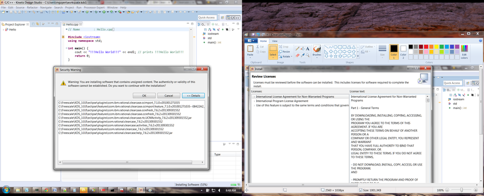

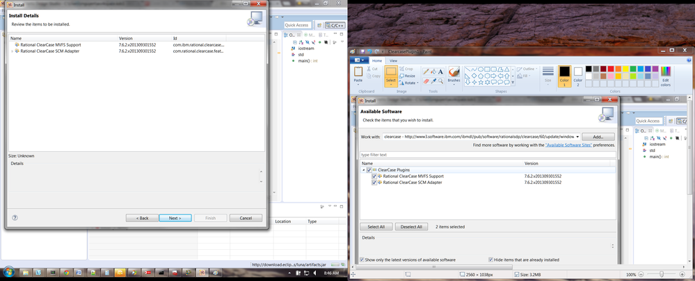

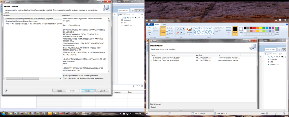

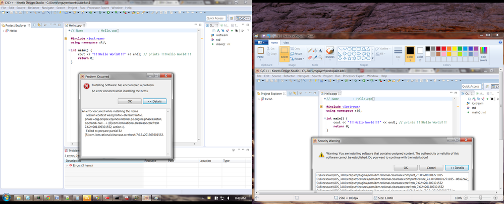

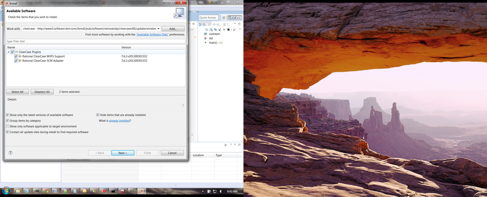

Clearcase plugin failed to installed with the following error msg:
An error occurred while installing the items
session context was:(profile=DefaultProfile, phase=org.eclipse.equinox.internal.p2.engine.phases.Install, operand=null --> [R]com.ibm.rational.clearcase.ccrefresh 7.6.2.v201309301552, action=).
Failed to prepare partial IU: [R]com.ibm.rational.clearcase.ccrefresh 7.6.2.v201309301552.

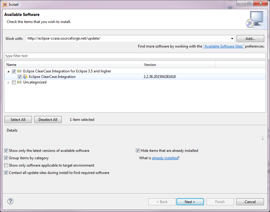

Please, have you tried to install plugin from these sites?
Clearcase plugin for Eclipse download | SourceForge.net
The same procedure, Work with you fill http://eclipse-ccase.sourceforge.net/update/
and you install updates.
After installation you will see the plugin in KDS
I hope it helps you,
Iva

please, can you show us to screenshot of the error message?

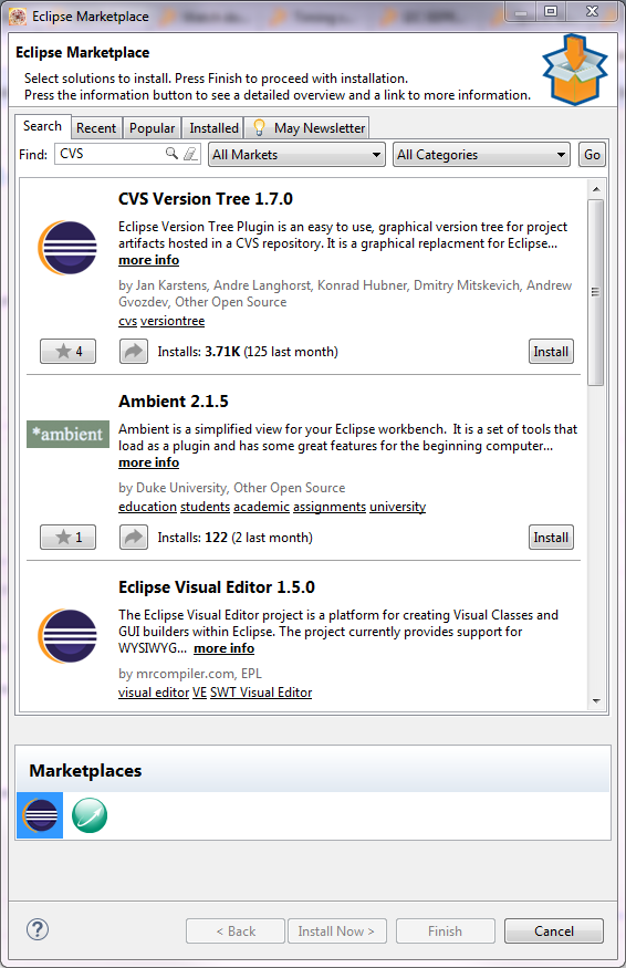

You can search plugins in KDS 3.0, Help -> Eclipse Marketplace
For example ClearCase you could find under CodeCollaborator (in KDS 2.0),
Or others like SVN: Subversive, CVS: CVS version tree, Git eGit
Thank you
Iva

robertnguyen
ClearcasePlugin1.pngClearcasePlugin2.pngClearcasePlugin3.pngClearcasePlugin4.pngClearcasePlugin5.png

robertnguyen
Hi Iva,
Your procedure works for me. Thanks a lot.
Robert
