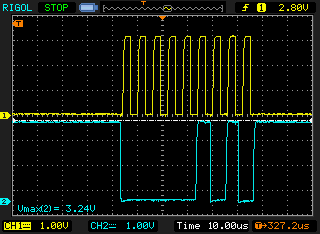

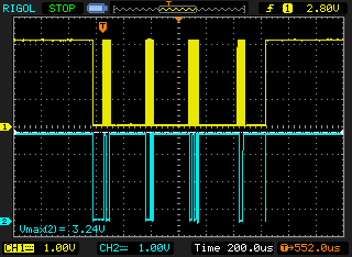

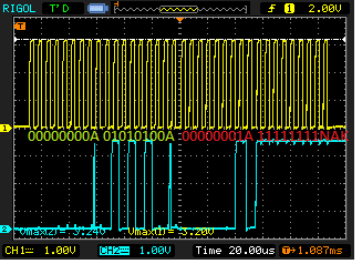

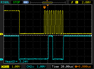

syed_idris
Alice,
We are using MCP9805 as slave chip.
waveform of KL03 interfaced with MCP9805 is as below
to confirm that our slave device is OK or not we checked it with arduino. It is working fine,
waveform of arduino interfaced with MCP9805 is as below
Idris

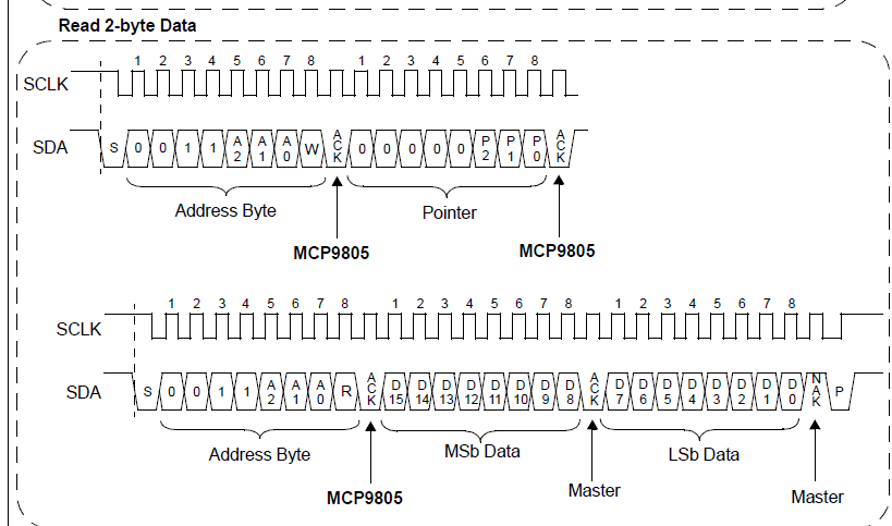

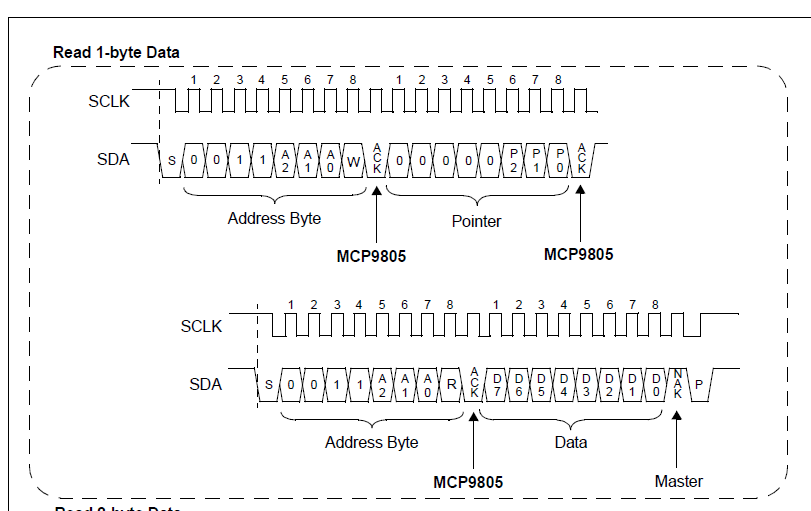

Hello Syed,
What about the waveform ? Read one byte or two ?
While from the datasheet of mcp9805, when read one byte ,it should show four byte :
when read two byte , it should show five byte :
So what about the wave ?
Alice

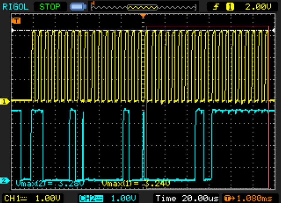

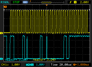

syed_idris
Reading 2bytes from 9805 gives
>>Reading 2bytes from 9805 gives 1st byte as
>>Reading 2bytes from 9805 gives 2nd byte as
>>Reading 2bytes from 9805 gives 3rd byte as
>>Reading 2bytes from 9805 gives 4th and 5th byte as
Sorry for lengthy post,
I thought it will help you to guide me,
For 1 byte reading the data what we are seeing on waveform as we are getting on console output are perfect.
but for reading 2 bytes what we are seeing on waveform (Address+W,  Register pointer, Address+R, MSB, LSB) in that the data which is on 4th byte (MSB) and 5th byte (LSB) we are not getting them on console output.
Idris

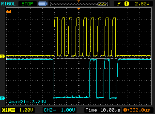

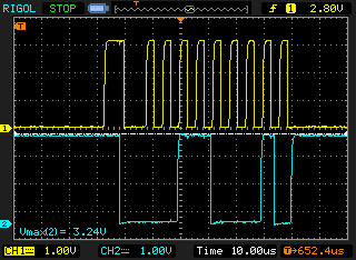

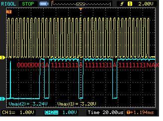

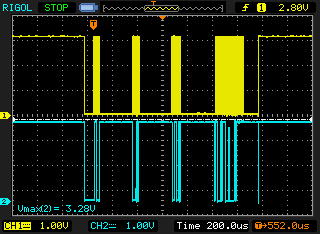

syed_idris
Alice,
I attached here the waveform of 4th and 5th byte while reading 2 bytes from MCP9805.
But as the MCP9805 is digital temperature sensor and these two bytes are for determining the ambient temperature, so it's data will change as ambient temperature changes.
Idris
10,226 Views

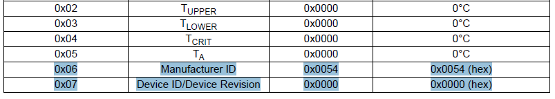

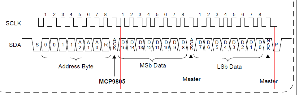

Hello Syed,
The last picture not only just the waveform of 4th and 5th byte ,from the
datasheet, it only includes MSb Data and  LSb Data :
from the screenshot of your picture , i think the last part is the MSb and LSb Data :
you can compare the two picture , the two data is  1 FF  .
So the master(kl03) show is right data , there is no wrong about the kl03 code .
Hope it hleps
Alice

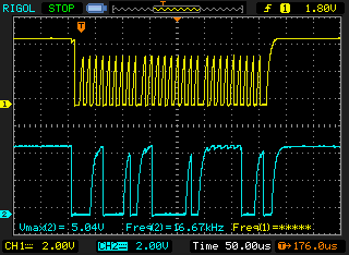

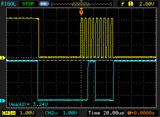

syed_idris
Hi Alice,
I don't think 0x01FF is the right data which is expected,.
To elaborate my view I'll write few points here
>>POINT-1: We checked on Arduino with MCP9805 it is showing 0xC1E0 as two bytes.
>>POINT-2: As per datasheet if we are reading two bytes then there should be only 2 bytes after 3rd byte (Address+R) then NAK
but as observed on I2C bus we are getting 4bytes after 3rd byte (Address+R) then NAK
>>POINT-3: I can say that 1 FF is the appended data to our expected data, because the temperature data is changing we are unable to say that in waveform which is our expected data,
so I just tried reading the Manufacturing ID and device ID registers
  • While reading 2 bytes from register 0x06 shows as
so green colored is 0x0054 is as expected and red colored 0x01FF is appended,
  • While reading 2 bytes from register 0x07 shows as
so green colored is 0x0000 is as expected and red colored 0x01FF is appended,
So When I am trying to read two bytes from register why I am getting 4 bytes on I2C bus? :smileyconfused:
>>POINT-4: For exploring more I tried for reading 3 bytes from register 0x06 .instead of showing 3 bytes it was showing 6 bytes.
after expanding
so first 2bytes 0x0054 is as expected and red colored 0x01FF 0xFFFF is appended,
and for this 3bytes reading I was suspecting I'll get FF FF on console for printing buffer[0] and buffer[1] but I got 1 FF. :smileyshocked:
Idris

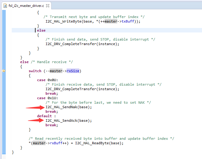

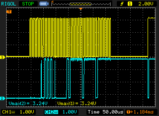

Hello Syed,
Thank for your explanation , it  very cleay !
The reason of slave send more than two bytes is after it send 0x0045 , the master
not send NACK.
So I  check the KSDK i2c driver code today , i think maybe there is a bug in the code.
While i don't sure . After  slave send two bytes (for example the count =2), master should send NACK.
While from the waveform , it send ACK . So  please set breakpoint on the interrupt function , check
the first received data , then  step by step to run , check whether it have issue or bug .
In the function of  void I2C_DRV_MasterIRQHandler(uint32_t instance):
Another method is use the latest version of KDSK v2.0 , it fixed the bugs which ksdk1.3 have .
You can see the ksdk1.3 really have some issue :
Strange behaviour in i2c driver (KSDK 1.3.0)
I2C+KSDK+PE+Interrupt Problem
About the download and use of KSDK v2.0 , please refer to here :
https://community.nxp.com/docs/DOC-329662
Hope it heps
Alice

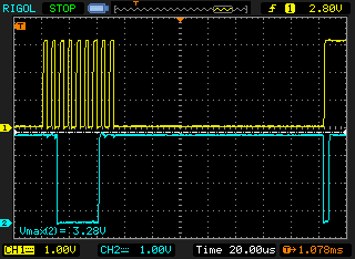

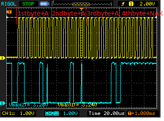

syed_idris
Hi Alice,
I will attach here the details of waveform.
Reading 1byte from 9805 gives
I'll give the more snaps byte by byte
>>Reading 1byte from 9805 gives 1st byte as
>>Reading 1byte from 9805 gives 2nd byte as
>>Reading 1byte from 9805 gives 3rd byte as
>>Reading 1byte from 9805 gives 4th byte as
