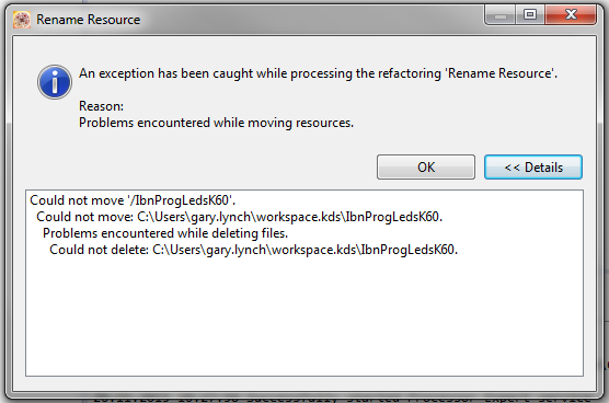

garylynch
When I follow the steps in the video, after the first step
(RgtClk >> Rename) I get a different diagnostic message:
I can complete the second step and build the project under the new name.
I can launch the debugger but get a diagnostic that the
debugger can't find main.c, because it is looking in the old
folder, C:\Users\gary.lynch\workspace.kds\IbnProgLedsK60.
That folder still exists, but is empty.
What did I do wrong?
