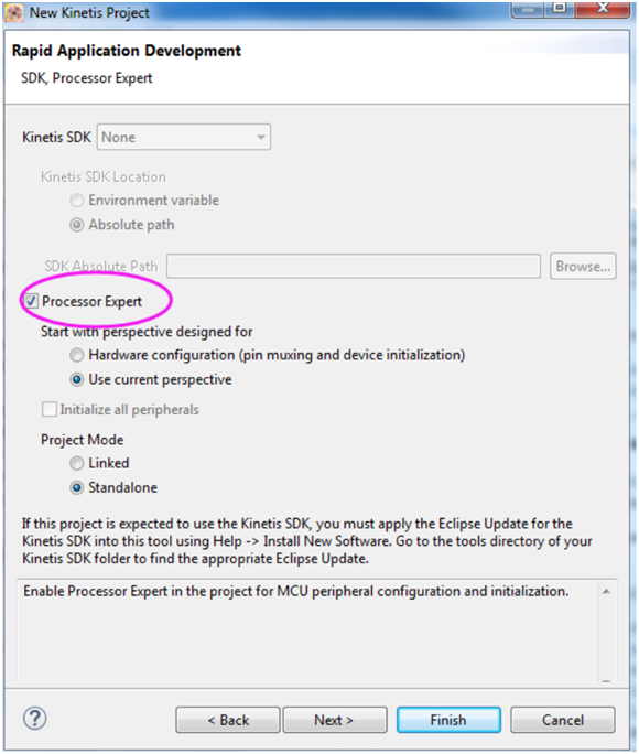

Hello James,
I think the easiest way is create a Processor Expert project on KDS:

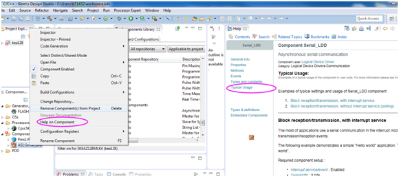

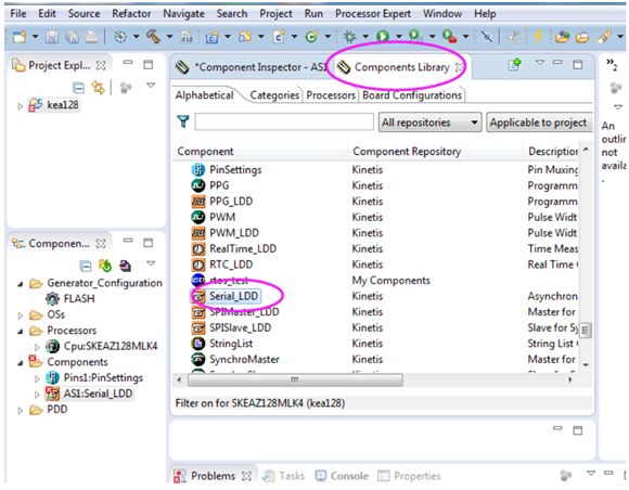

then add the component of  "Serial_LDD"
There is demo code under  under "Typical Usage" :
