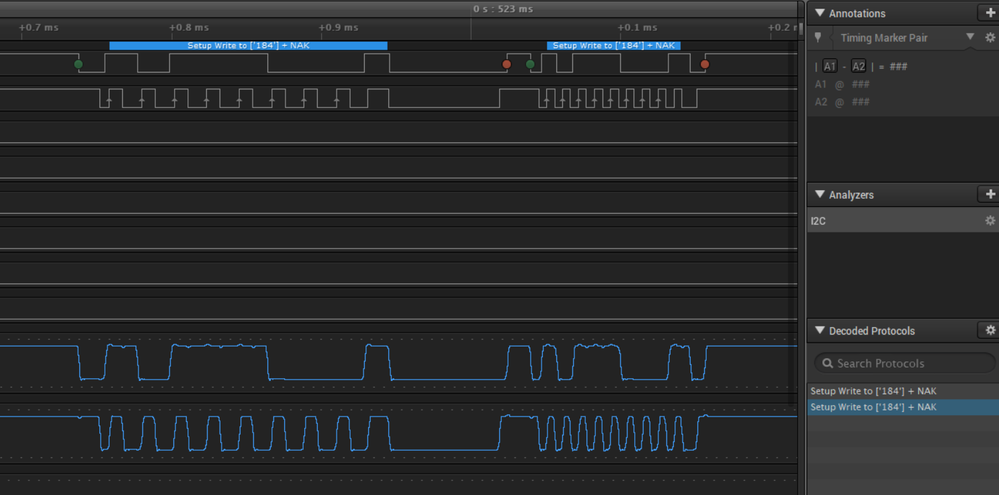

Greetings!
I am using the K22FN256LH12 microcontroller with KDSv 3.2 and Processor Expert, and I am trying to get it to work with this AM2315 temperature sensor. I am currently using the I2C_LDD to communicate through I2C to other peripherals as well as this one. This sensor keeps giving me issues though. The first image below is of the sensor working correctly on an arduino, and the second is mine. I do not understand why I keep getting a NACK, any suggestions?
Here is my code, I had to bit bang the first "184" since it needs a unique delayed stop...

Any ideas would be much appreciated!
