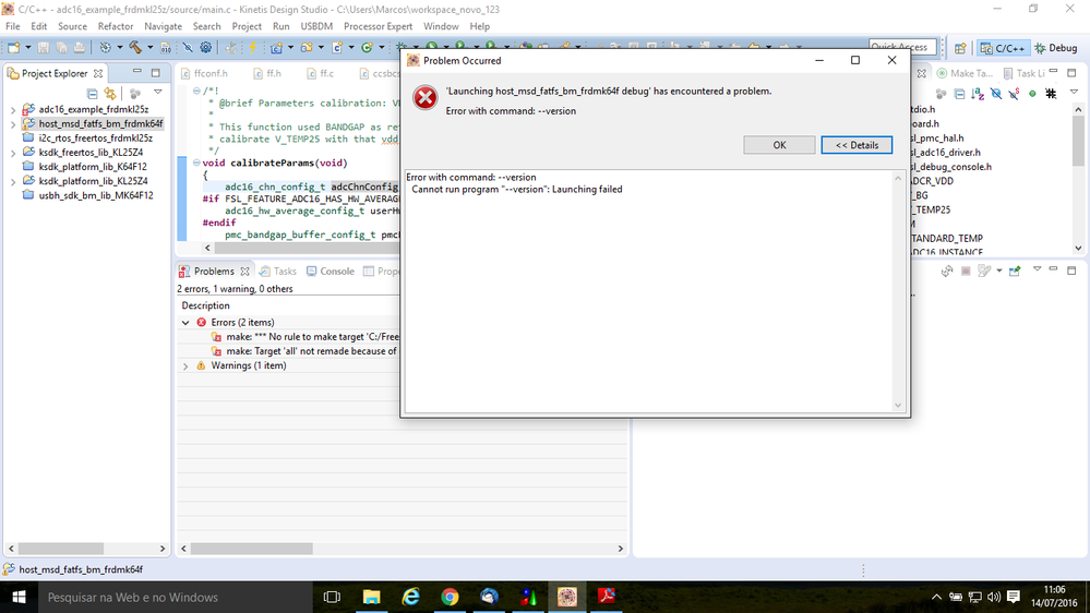

I just bought a programmer running your USBDM from Luciano in Brazil.
Could you please explain me how to install USBDM plugin to make KDS 3.2 recognize USBDM programmer? I have carefully followed your video in USBDM with Kinetis Design Studio and Kinetis SDK - YouTube and just changed the paths to KDS 3.2 and KSDK 2.1 paths.
I'm struggling to make it work, but it has been a difficult task.
I also tried in KDS 3.0.0 and pointing to KSDK 1.3. I have all of them installed on my computer. But it fails with all the alternatives.

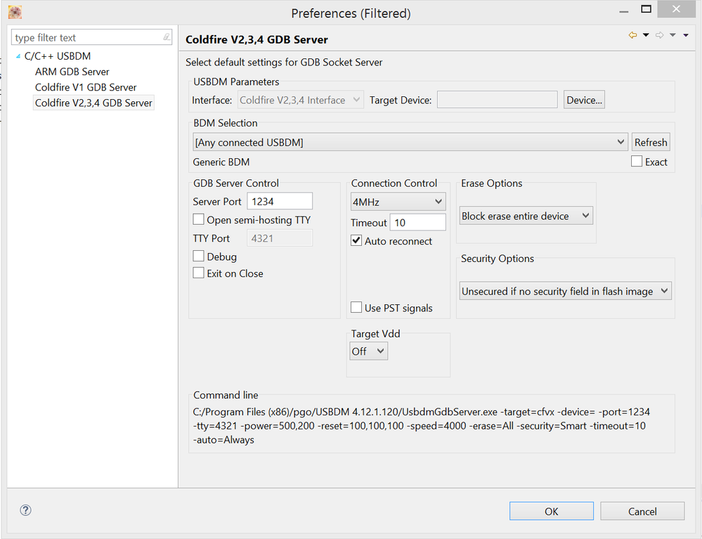

Hi Marco,
I have only just come across this thread.
The above error is caused by a invalid or missing setup file that then upsets the dialogues you are using.
The error only occurs is a certain sequence is followed but once it occurs it is persistent.
Please try the version just uploaded which has a fix for this : USBDM_4_12_1_120_Win.msi
You should probably also delete the %APPDATA%/usbdm folder which contains the invalid setup.
Alternatively I believe the error may also be fixed by opening the USBDM->Configure menu and visiting all the config pages (expand the menu at the left).  Ignore any error messages.  Once a valid config is created the error no longer occurs.

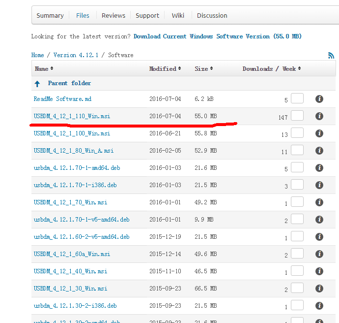

Hello Marco,
I test your attached project , it also can work well :
So it not the reason of project.
Which system do you used ?  Please uninstall your USBDM software , then install the latest version :
USBDM - Browse /Version 4.12.1/Software at SourceForge.net
Pay attention that,  when you install it , select the right path of KDS, you'd batter take  a screenshot about it.
If still can not used ,  please install the KDS again , and install the latest version of KDS V3.2 .
Hope it helps
Alice

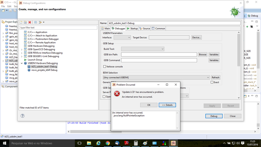

If I try to create a new project through USBDM menu, I get this error:
Java is up-to-date in my computer.

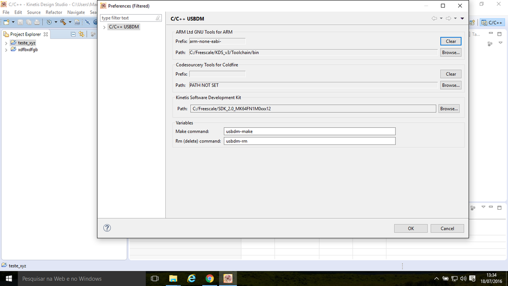

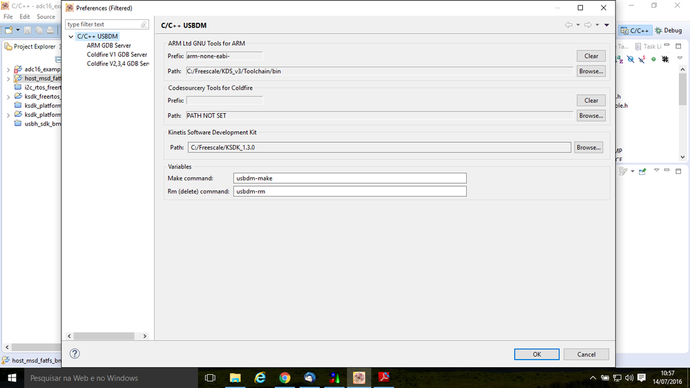

My USBDM configuration (with KSDK MK64FN1M0xxx12 v2) looks like this:
I give it up!

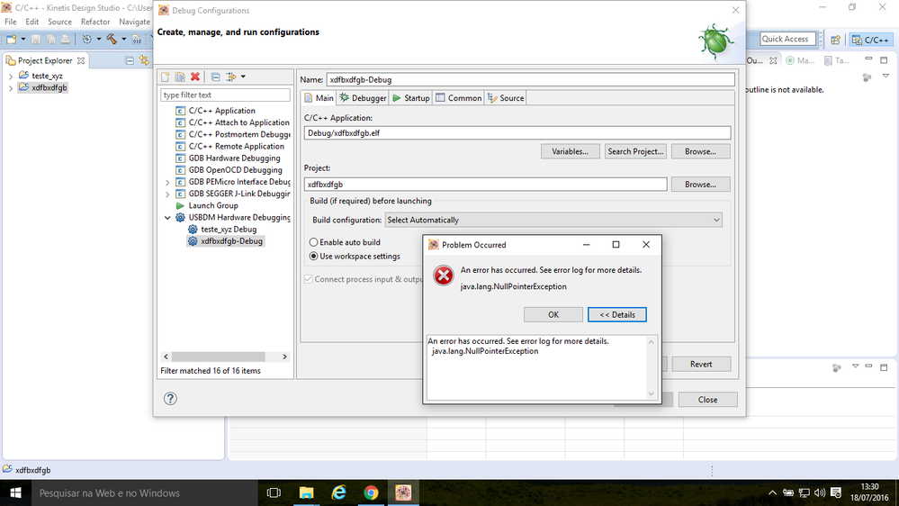

MAPC
Senior Contributor I

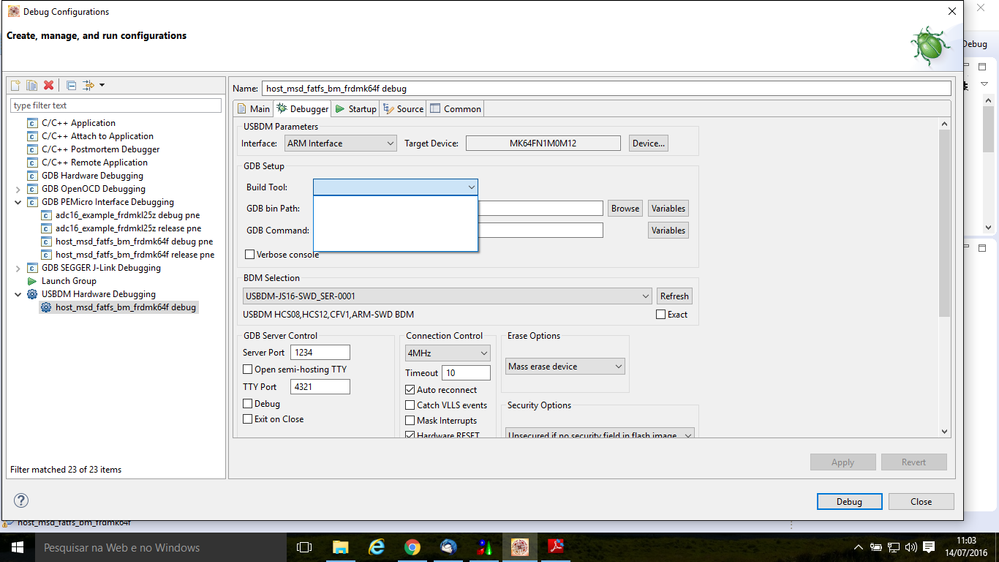

As I hit Refresh Button in Debug Configuration, it shows the following error:
7,992 Views
MAPC
Dear Alice,
Please have attached my code. This code was originally created in KDS (KDS Project Creator) for FRDM-K64F (P&E Open-SDA) with KDSK v2. I didn't create a new project through USBDM menu.
I'm trying to program my FRDM-K64F through USBDM programmer, but it fails. As I showed in my previous message, the selection field relative to "Build Tool" doesn't show anything. Is is in blank. Maybe you can reproduce the same error on your side.

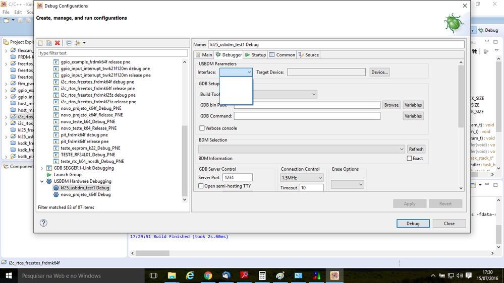

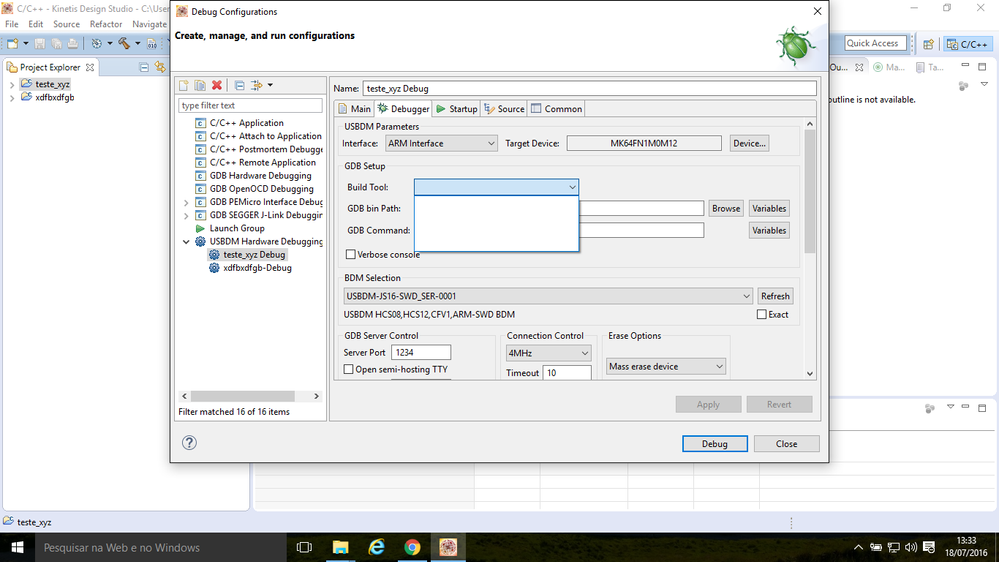

I think my configurations are correct. See bellow my USBDM and Debug Configurations in KDS 3.2:
One point that called my attention is that "Build Tool" selection field in "Debug Configurations" is in blank.
As I try to program the MCU and go to Debugger, I get this error:

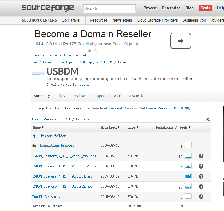

First , please be sure you have in stall the USBDM Ddiver (not the USBDM software )?
USBDM - Browse /Version 4.12.1/Drivers at SourceForge.net

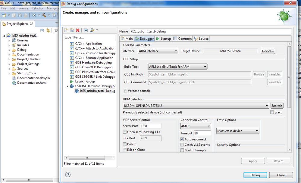

Second ,  when you create project, have you select the Build tools :
The attachment is the project i test on FRDM-KL25, you can test it on you side .
The debugger configuration on my side is like this :
