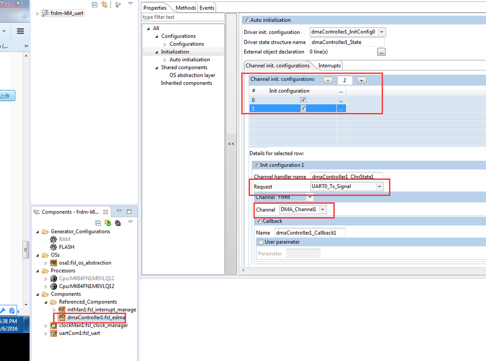

Hello Peter,
I assume you said the eDMA callback .
In the PE, you can configure it at here :
After generate code , you can find :
I think use the callback  is optional , if you want do something after one DMA channel, you can realize it
in the function : dmaController1_Callback0(). You can have a test .
Hope it helps
Alice

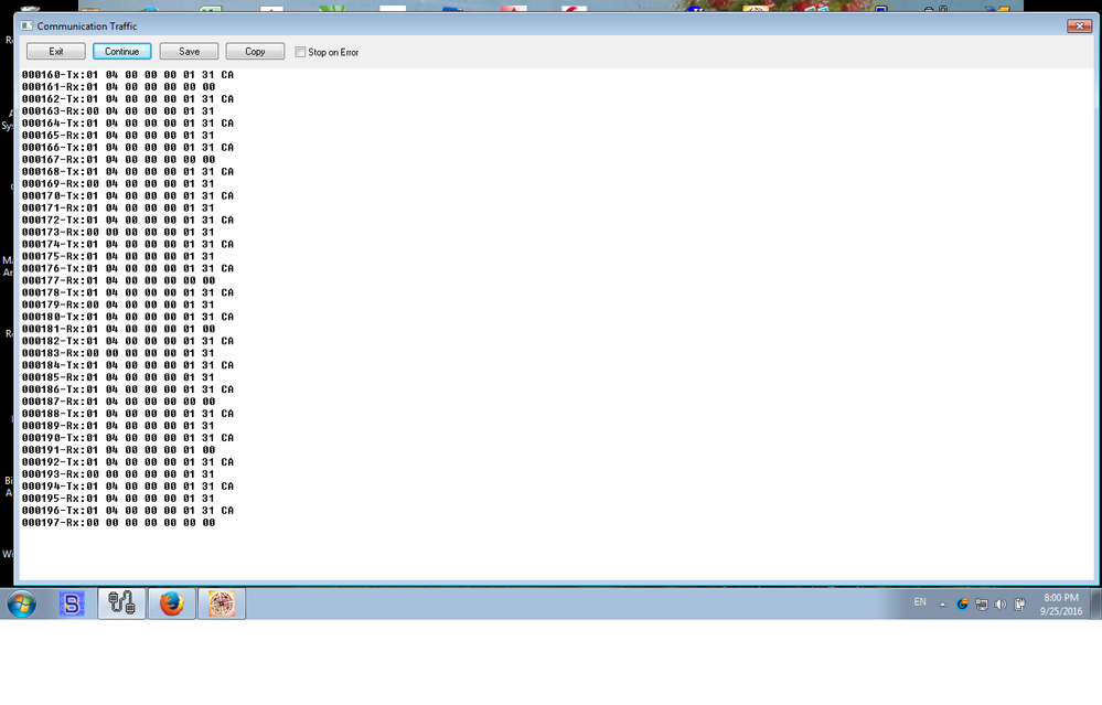

I have tried your suggestion and it sort of works. The only problem is when receiving data, it misses the last character and substitutes 00 at other character positions. Example, I receive 8 bytes and echo them using...
static void rs485Task( void *pvParameters )
uint16_t *reg, N,base,k;
reg = (uint16_t *)pvParameters;
static uint8_t buf[255];
UART_HAL_SetTransmitterRtsPolarityMode(UART0_BASE_PTR,true); // use RTS to enable RS485
UART_HAL_SetTransmitterRtsCmd(UART0_BASE_PTR,true);
while(1)
if (kStatus_UART_Success == UART_DRV_EdmaReceiveDataBlocking(rs485_IDX, buf, 8,OSA_WAIT_FOREVER))
UART_DRV_EdmaSendDataBlocking(rs485_IDX, buf, 8, OSA_WAIT_FOREVER);
..........etc
Here is a typical log of data (TX) sent by an external source vs. what has been received (RX):pastedImage_1.png
I am using UART0 with its 4 byte fifo. Should the fifo be disabled when using DMA?
Any other suggestion?
Many thanks
Pete
5,491件の閲覧回数
Hello Peter,
Please disable the UART fifo to have a try .
Alice

This looks promising. But when I set fsl_uart  to DMA mode, PE automatically installs fsl_edma as a referenced component.
How can I get rid of fsl_edma and use Init_eDMA instead?
Pete
5,491件の閲覧回数
Hello Peter ,
Sorry for my mistake.
It isn't need add the component of "Init_eDMA " .
When configure the fsl_UART to DMA mode :
there will be add the component of "fsl_edma" automatic .
Then we can utilize this component
then refer to the demo code to have a test.
Hope it helps
Alice

Hello Peter,
Sorry there is no SDK+PE demo .
Yes, it is possible to use the SDK+PE , you can add the two component of
"Init_eDMA" and "fsl_uart" :
Then configure the Properities :
About the code  , you can refer to the demo under KSDK without PE.
For they use the same functions .
Hope it helps
Alice

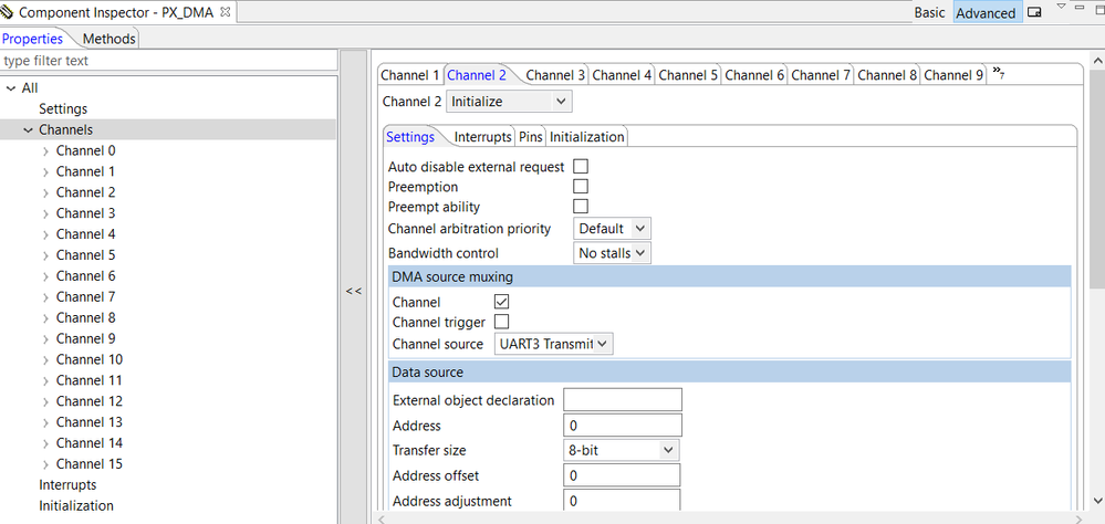

aalakh_devari
Hello All,
i am trying to setup the configuration for DMA with UART for Transmission using Processor expert but i dont get the option of component mode in UART as "DMA mode"
Can anyone tell whether i m missing any component...
I could setup the DMA Channel as shown below:
With Regards,
Aalakh Devari
