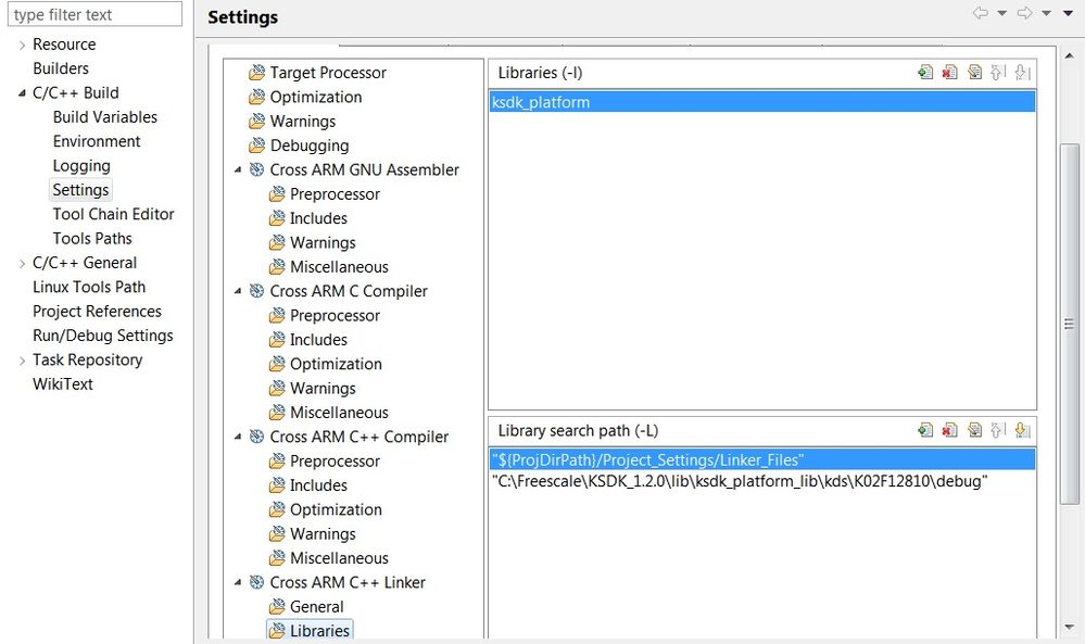

And my includes and linker libraries
6,887 Views

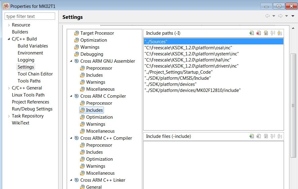

After building the corresponding platform library, I created a kinetis project from the scratch:
- New project with KSDK 1.3 for MK02FN128xxx10.
- I added the platform library and library path to linker settings.
- I added the following include paths to C compiler settings:
      ../platform/hal/inc
      ../platform/drivers/inc
      ../platform/osa/inc
      ../platform/system/inc
It builds fine if I do not invoke any GPIO function of fsl_gpio_driver, but these errors appear when I try to use those functions.
