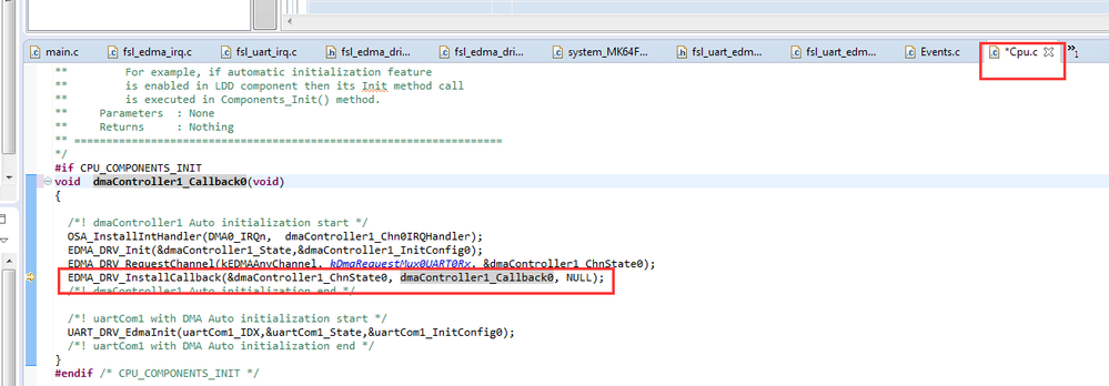

Hello Peter,
I assume you said the eDMA callback .
In the PE, you can configure it at here :
After generate code , you can find :
I think use the callback  is optional , if you want do something after one DMA channel, you can realize it
in the function : dmaController1_Callback0(). You can have a test .
Hope it helps
Alice

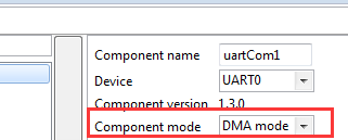

Hello Peter ,
Sorry for my mistake.
It isn't need add the component of "Init_eDMA " .
When configure the fsl_UART to DMA mode :
there will be add the component of "fsl_edma" automatic .
Then we can utilize this component
then refer to the demo code to have a test.
Hope it helps
Alice

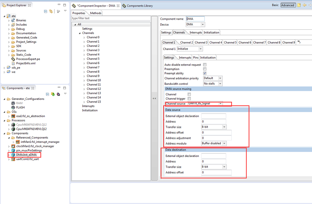

Hello Peter,
Sorry there is no SDK+PE demo .
Yes, it is possible to use the SDK+PE , you can add the two component of
"Init_eDMA" and "fsl_uart" :
Then configure the Properities :
About the code  , you can refer to the demo under KSDK without PE.
For they use the same functions .
Hope it helps
Alice
