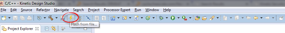

The behavior you are experiencing happens because when you use the Debugger to flash your device, it will perform the download to the device but then it will try to start the debug session and will notice that the device is secured, so the debugger will perform a mass erase on the device to unsecure it and be able to debug the code. I would recommended not to secure the device in the development phase of the project.
You can use the "Flash from file" utility in order to flash your device when the security is enabled :

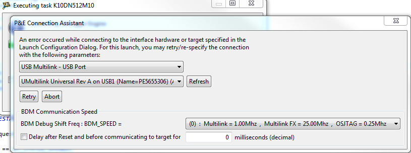

After you click on it a window will show up where you can select the connection to use:
Hope it helps!

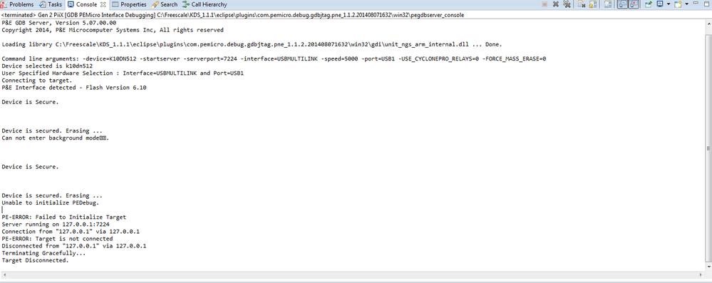

and i then tried to use debugger in KDS1.1.1, it shows the below information in the Console Tab:
So now i have no way to reflash the K10 any longer
Do you know why and what is the solution for me?

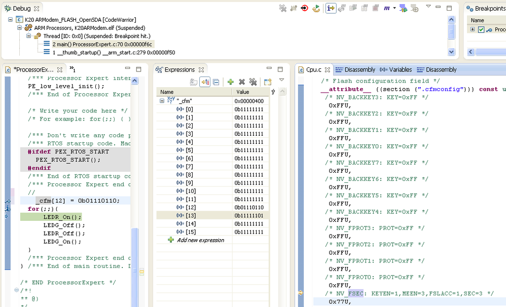

I think the mass erase is enabled in my image.
I have checked the s record file I am using,  the MEEN bit is actually set to 3 which means the Mass erase is  enabled
Here is the flash configuration line in the s record file I had flashed into K10
S214000400FFFFFFFFFFFFFFFFFFFFFFFF7CFBFFFF7E
You can see that the value of FTFL_FSEC is 0x7C
but the  FTFL_FOPT is set to 0xFB, which means NMI_DIS is 0, is that safe?

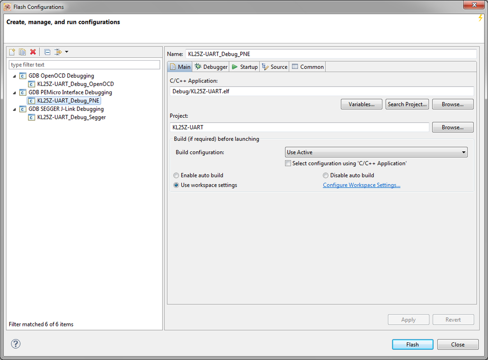

I'm using the P&E multilink.  It appears that the flash tool does the same thing as the debug tool.  Has the same options, same log messages.  I don't see a way to stop it from trying to step thru code and erasing when it can't.

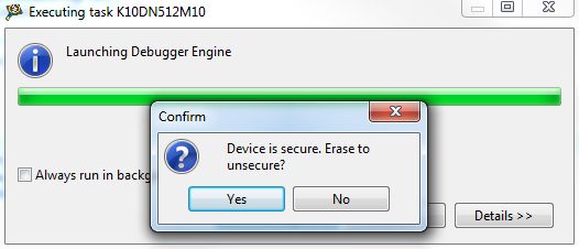

I have done some test and the mcu cannot be secured using P&E multilink and KDS, this is because KDS does not have the feature to allow pop-up dialogs, because of this the user cannot be warned that the chip is secured and choose whether to erase the flash or disconnect from the debugger, so without the pop up it gets automatically erased.

Just a note to add to Mr. Mendoza's correct analysis in that currently KDS is missing the popup dialogs when using P&E hardware interfaces. These dialogs will be put into the next build of KDS, whenever that may be. So it is important to keep up to date on the KDS version to get the latest features and bug fixes.

KDS3 with the P&E dialogs still fails to program an image that has flash lock compiled into it.  The dialog comes up where it asks if you want to erase flash, and clicking yes causes the same thing to happen as in KDS1.  It erases the chip and then tries to run on an erased chip.  It never writes the image.  When I disable flash lock and recompile it is able to flash the device without problems.  We are aware that a jlink will work but we already spent a lot of money on a P&E device and feel that we shouldn't have to buy 2 expensive debuggers.
