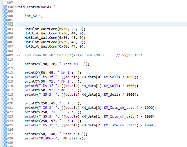

a)  I have a lot of code (written fo CodeWarrior and MQX) where I use something as:
the printXY() is my functin for printing unformated string directly to the position X,Y on the TFT.
Problem in this case is, that there are no "\n" in printf() functions and the strings from all printf() functions
is outputted when the internal buffer (0x400 long) is full (or on first "\n").
But the printXY() function outputs the string imediately.
I can solve this problem when i'll insert "\n" into every printf() (its plenty of code).

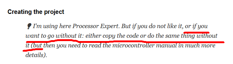

Or if you want write by yourself , i think you can copy one _writhe() code , there is a sample about this "
https://mcuoneclipse.com/2013/02/07/tutorial-printf-with-and-without-processor-expert/
