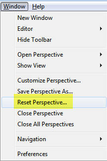

BlackNight
Hi Brian,
I have it visible:
Maybe you could try to reset the perspective?
I hope this helps,
Erich
