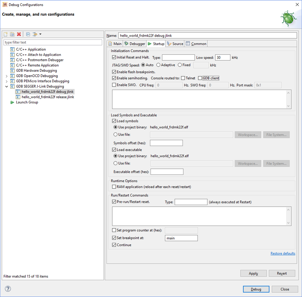

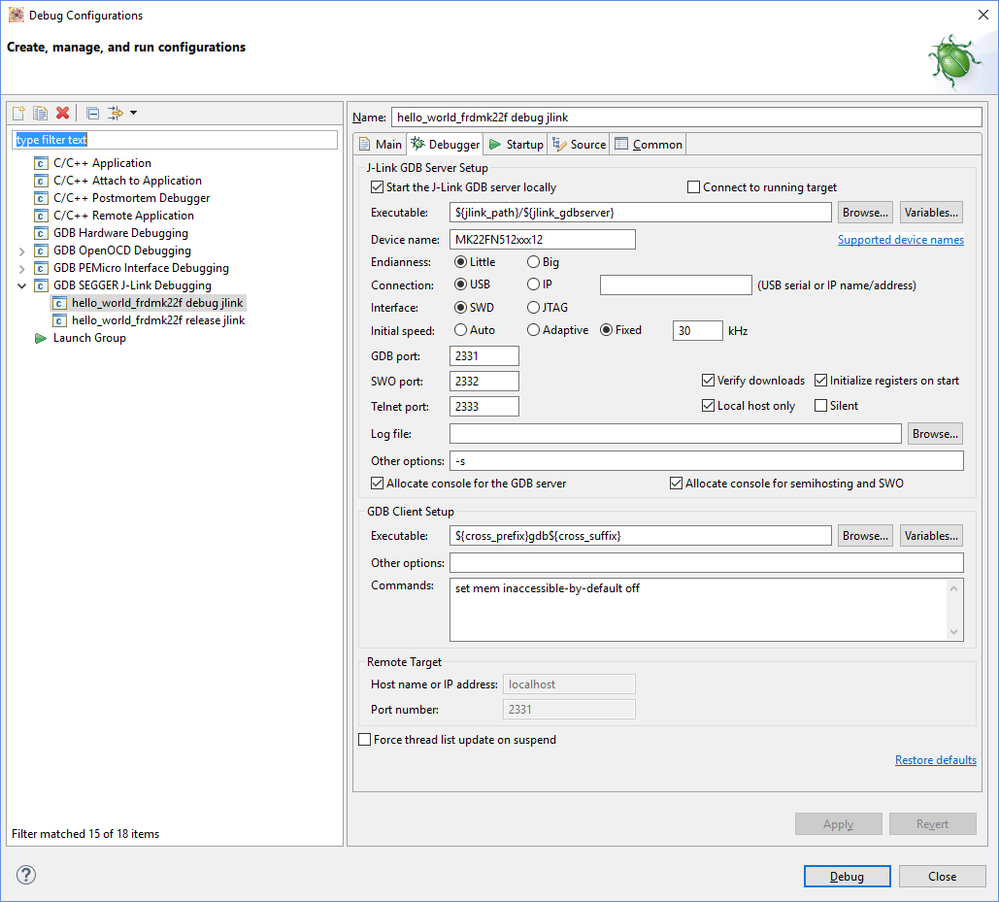

I am trying to get the hello_world example running a K22F Freedom board using KDS 3.1.0 and a Segger J-Link. The application runs in debug mode, the LED flashes and it responds to break points. I do not see the "Hello World!" ouptut n the Semihosting and SWV console window, the code alos hangs waiting on GETCHAR. I tried having the debug output to Telnet with no luck either despite having a valid Telnet connection. J10 and J13 have been disconnected and I am powering the board via USB (Not the OpenSDA connector).
Am I missing a settings somewhere?
