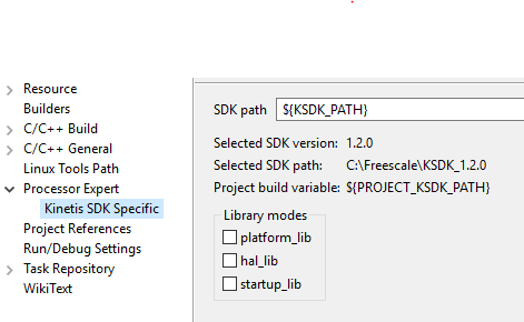

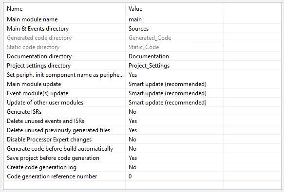

Here are my KSDK and Processor Expert preferences:

From the screenshots it seems everything OK. I'd double check that the KSDK_PATH environment variable is available and with correct value during the headless build (if it is executed via any continuous integration system or with another user it may result in different environment set), e.g. echoing to the console just before the build is executed.

You were right!  The KSDK_PATH variable is not being used.  Probably because I had set it as a User environment variable, rather than a System one.  That was dumb.  I'm rebooting the server to see if that changes anything, and will mark your answer once I find it!  Thanks!
