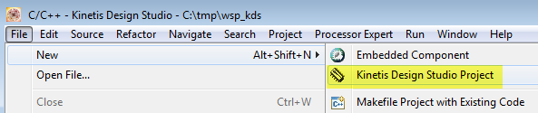

BlackNight
Hi Jeff,
I think you are not using the correct toolchain. Have you created your project with File > New > Kinetis Design Studio Project?
Erich
2,893 Views
