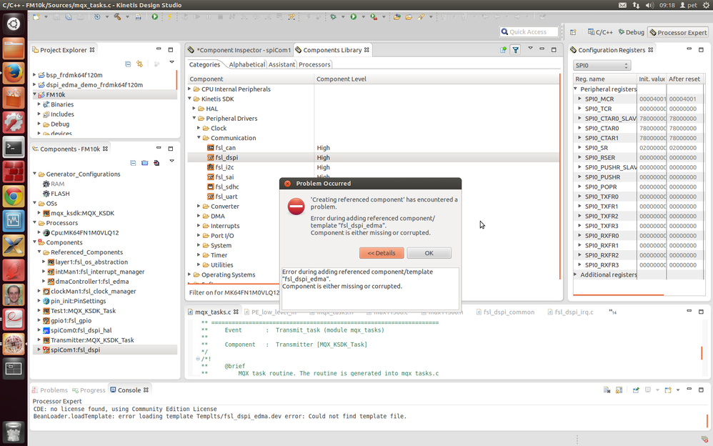

I use Kinetis Design studio 1.1.0 with Processor expert, (uc MK64F),
I want to create a DSPI : first i create a component DMA (component library -> kinetis SDK -> peripheral driver -> DMA -> fsl_DMA) then i try to create a component DSPI (component library -> kinetis SDK -> peripheral driver -> communication -> fsl_DSPI) but the following message appear :
" Error during adding referenced component/template "fsl_dspi_edma".
Component is either missing or corrupted. "
Can you help me ?

tapiepierre
Hello Carlos,
Thanks for your answer but I have already instal the update for Kinetis Design Studio, so the problem still occur.
I work on Ubuntu 12.04 and I use MQX KSDK
When I want to add the fsl_DSPI to my project the following message apear :

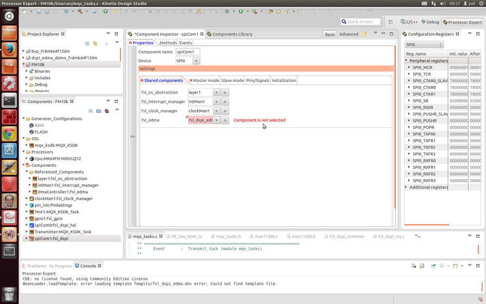

And when I go in Properties of the component :
Thanks for your help,

marek_neuzil
Hello Pe Tapie,
I have reproduce the problem on Linux Ubuntu 14.04 32-bit (there is problem with a path). Processor Expert team has prepared a hot fix, see the attached package.
Please, copy the content of the package into you installation, see detailed instruciton in release notes (hot_fix_KDS_1_1_0_PEXMCU-288.txt) in the hot fix package.

tapiepierre
Hello Marek,
Thanks for your answer, the directions you gave me allowed me to solve the problem.

Hi PE,
I refer to your screenshot make a try , there is no errors. and you can  add the component "fsl_edma" through fsl_edma  ->  new component ( in the screenshot ) .
Hope it helps
