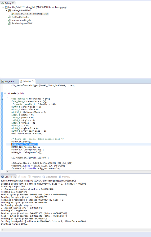

How do i get code to run on my mk22f?
on Windows 7
using Jlink bootloader. (Have used PE Micro with same results)
Kenitis Development Studio v3.2.0. (have also Tried IAR and mbed same result)
SDK: SDK_2.1_FRDM-K22F
I am using the demo projects located at.
C:\Freescale\SDK_2.1_FRDM-K22F\boards\frdmk22f\demo_apps
The projects will build and download. I can enter the debugger and step through the code but, the functionality of the projects does not show, meaning that Bubble demo does not show red or blue LED's when the board is tilted. also the Hello world program does not blink LED's or show anything on the terminal.
During the running of the bubble demo I can step through the code to the highlighted line

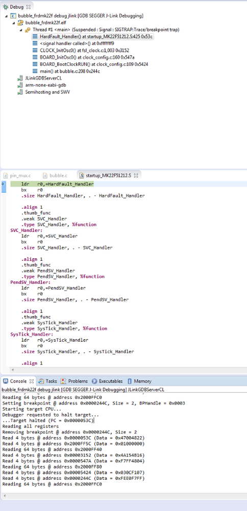

At that point I can no longer step through the code when I halt (pause) the code I am taken to this line.
What is a HardFault, is this why my code won't run? or is there something else causing this?

My steps were.
Import bubble project
Clean all
Build Project (Debug)
Debug Project as JEGGER J-Link
Step over function.
HardFault.
Ideas?

Hello ,
 I just test on FRDM-K22 jlink bootloader  about the Bubble demo, it can work well.
- Please change a new work KDS work space or delete the .metadata fold under your current work space,
then have a new test .
- If it still can not work well , please create a bare board simple project, without KDSK, check whether
it can work well .
Alice
