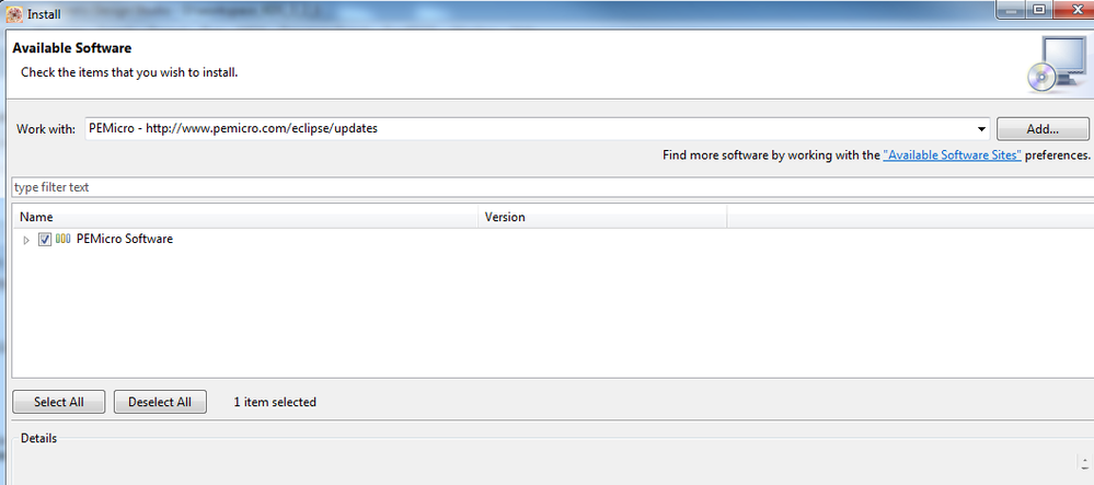

2. please make sure "skip all breakpoints " is unchecked
3. try to update your KDS P&E driver to the latest
PEMicro - http://www.pemicro.com/eclipse/updates

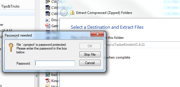

I download your demo project but can't unzip it. No password
Thus to simplify the issue, I did a demo code under KDS3.2 for wait mode testing(attached demo code). here is my testing result:

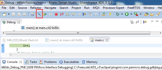

This time I created a brand new workspace then imported your project to it. see attached video (2017-01-17_16-29-43). because our community doesn't allow attachment over 10M thus I split it into two parts with zip. please download both 2017-01-17_16-29-43.zip.001 and 2017-01-17_16-29-43.zip.002 to a same folder then unzip it to one file: 2017-01-17_16-29-43.mp4.
I install KDS3.2 with some updates: P&E updates and KDS updates. I made video for you to show my updates install.
I suggest you perform menu "help", "Check for updates" to install all of them.
Please let me know if where I am wrong or if your problem can be fixed after install the updates.Thanks!
Jennie Zhang
19,907 Views
mjbcswitzerland
Specialist V
Hi Jennie
I checked for updates and it installed new "GNU PEMicro Interface Debugging Support" and now it is possible to debug the project!
This has taught me an important lesson:
- Although I installed KDS3.2 before trying it doesn't mean that it has latest drivers or plug-ins - therefore always check for updates immediately
I will now inform all users to do the same to verify that there are no further issues.
Thanks!
