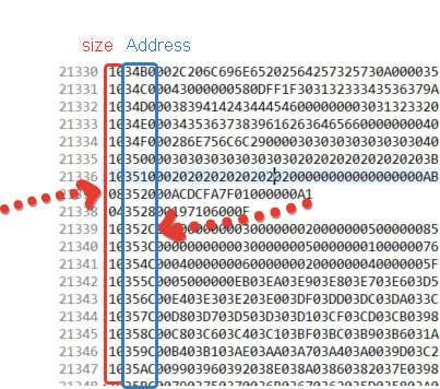

When I'm asking the KDS complier to create in addition to the elf file a HEX file there is just one critical problem : somewhere in the middle of the HEX file one of the packets size takes just 4/8 bytes and then the addresses of the rest of the file now is starting from a XXX8 and XXXC address which is not aligned anymore.
tring to program this packets on the flash returns with FTFx_ERR_SIZE (0x2000) error for the first 4 Byte packet and with FTFx_ERR_ACCERR (0x0020) error for the rest packets probably since the data is not 16 byte aligned anymore.
What is the solution for this situation? is there a simple way to enforce the compiler to create a 16 bytes aligned HEX file or i should invest more time with better robust algorithm for handeling the non-align data?

I have no knowledge with your bootloader, so I cannot tell exactly why it returns  ERR_SIZE and ERR_ACCERR error. Below is only a tip for your hex data align question.
The HEX file is not generated by compiler, it is created by tool “arm-none-eabi-objcopy.exe” from ELF file, this tool locates at:
C:\Freescale\CW MCU v10.6.4\Cross_Tools\arm-none-eabi-gcc-4_7_3\bin
For its options, please run “arm-none-eabi-objcopy.exe -help” to get the descriptions. Or refer to this link:
https://manned.org/arm-none-eabi-objcopy
Unfortunately This tool does not support align Hex data, I found a workaround, that is to first generate S-record file as below (this tool supports to align S-record data):
Then run “arm-none-eabi-objcopy.exe” to convert S-record data into hex, like below:
arm-none-eabi-objcopy.exe -I srec -O ihex sfs.srec fixed_result.hex
This is the comparison of HEX file generated in KDS IDE,  and the one converted from S-record file.
