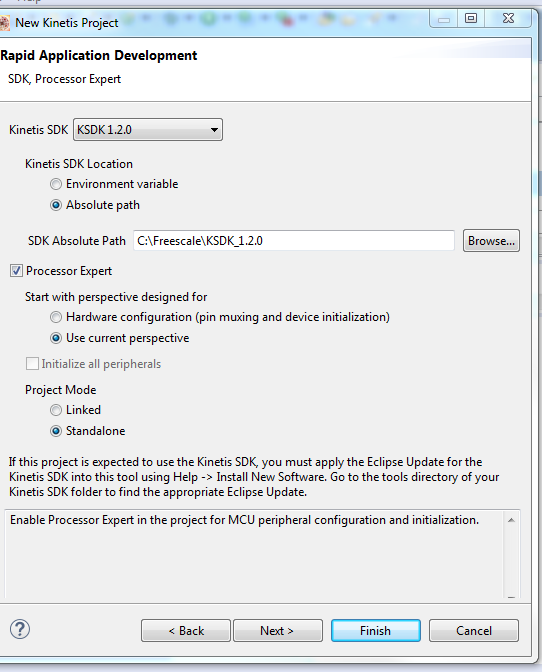

Hi All,
Please see the steps that i followed to create the project. Let me know if you guys need more information

jagadeeshk
Hi Alice,
I have done the both the steps that you mentioned in my initial setup only . I have mentioned the same in my post.
I have followed the docs that you referred in your reply.
Can you please elaborate on what configurations my project that you want to know.

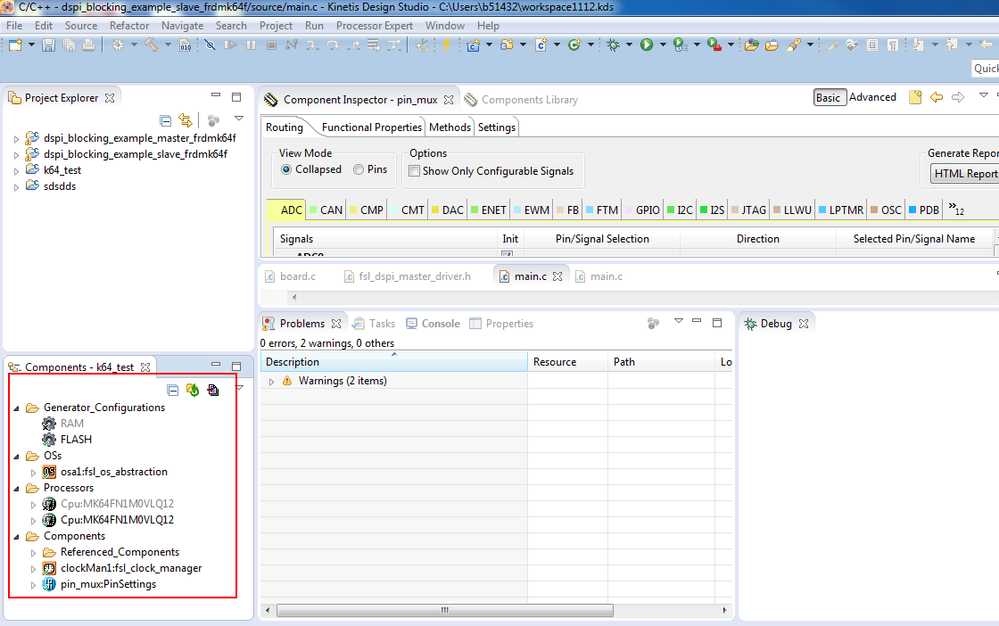

Hello K,
Please show  as this :
and also the components you use :
Alice
