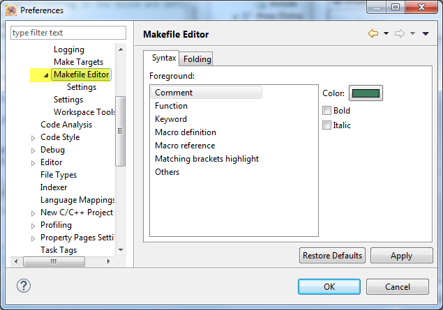

In addition, Makefile is automatically generated after a successful build under the same folder with .elf file.
user can edition makefile style and syntax in KDS preferences window.pastedImage_0.png
