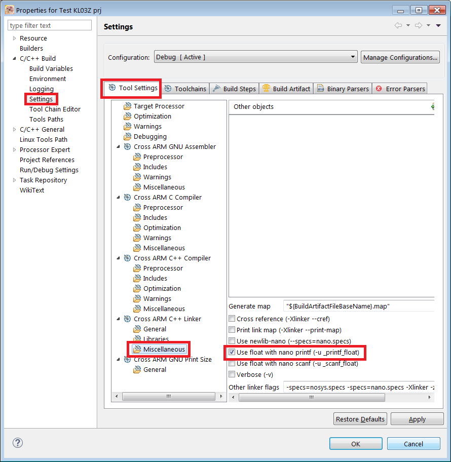

marek_neuzil
The support of float numbers in printf can be enabled by using linker options. For example, when you create a new Kinetis Project in KDS 3.0.0 (with KSDK 1.3.0 and Processor Expert) you can find the option in the Properties of the project, see the following screenshot:
Please note that when this options is enabled the target code (memory footprint) is significantly increased.

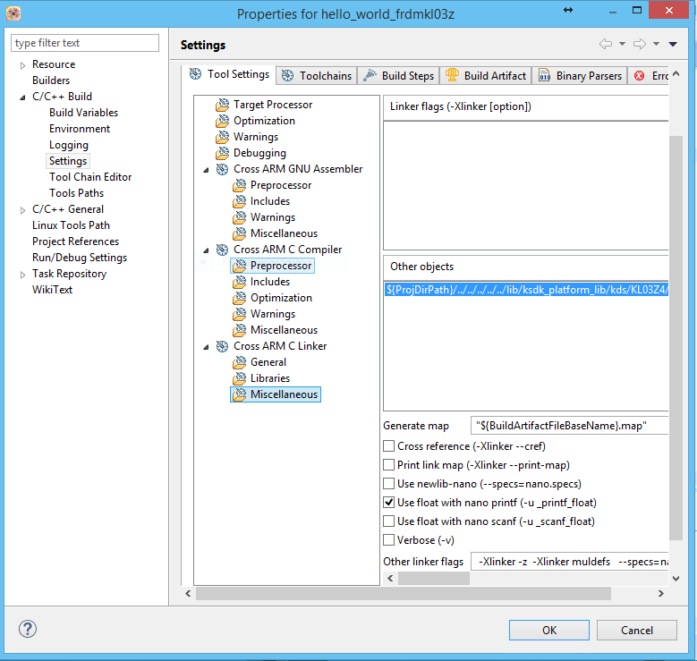

syedidris
Hi Marek,
Thanks for your reply,
I am not using processor expert, I am just editing in the Hello_world demo example with this float print.
I tried as per your suggestion, but I am not getting "Cross ARM C++ linker" option, I did in "Cross ARM C linker" but problem is not solved, Capture.PNG
can you please do something.

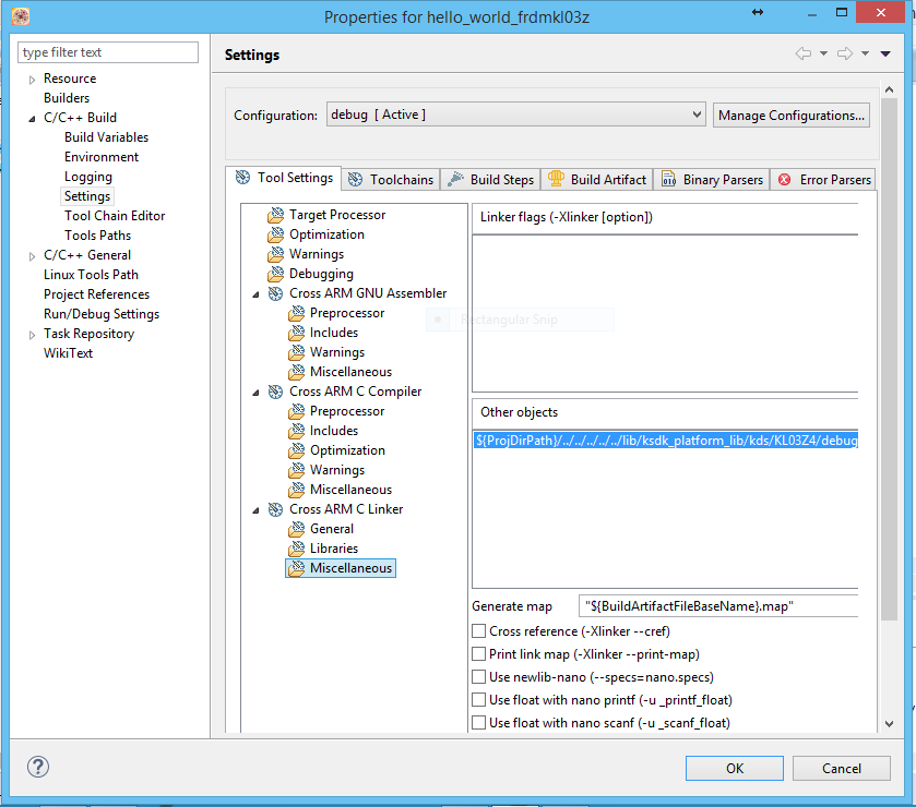

syedidris
Yes, I am using KDS 3.0.0.
In sample code of Hello_world example I just commented the statement
PRINTF("\r\nHello World!\n");
and replaced with statement
PRINTF("%f",1.23);
I am attaching my project file and also screenshot of my KDS properties.screenshot.PNG
