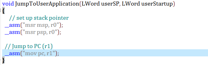

Hello Girish,
On kds , the jump application you can use this :
After load APP, you can compare the  memory with  when download the APP alone .
Hope it helps
Alice

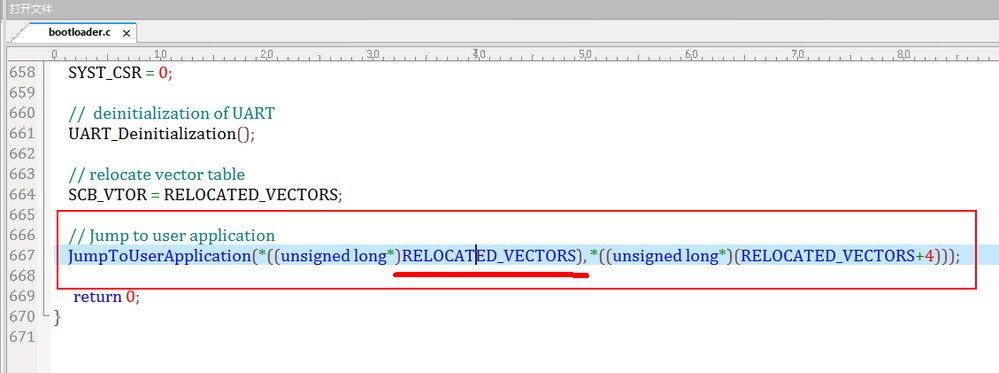

Hello Vastrad,
Do you used KBOOT or AN2295 ?
No matter which version , you can  find the jump address at here :
the MACRO of RELOCATED_VECTORS is the jump address , you can also change it refer to your demand.
And if you have flash the application into your board , you can check the memory , check whether it is right .
