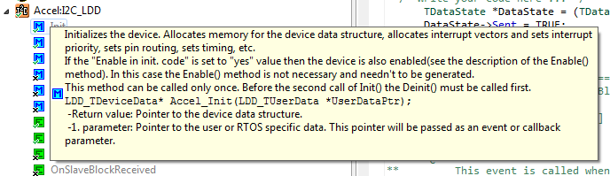

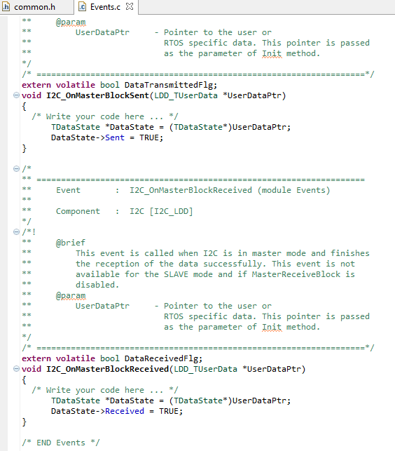

Okay, I've been perusing your code, and I noticed something interesting - at least I think I did...  Actually, now that I look at it, it makes sense, and I realize that I thoroughly misread the contectual help, etc...  So, I'll go ahead and post my ramblings here in the hopes that they'll help someone else...
So, in common.h, the following data structure is declared:
Fine and dandy.  I also see that the events generated on block sent/received "twiddle" this data structure.
Also fine and dandy, as we like our semaphores to tell us when things are done (especially when they're asynchronous), right?
So, looking at main.c, I see that a structure of the TDataState is declared (DataState)...
What I find interesting is that the pointer to this variable is handed to the init function...  When I read the context-sensitive help on this function, it gives the following:
I misread this such that I thought the pointer to be handed in was the pointer referenced in the Auto-Initialization contextual help below:
I understand, now, why things were not working correctly!
So, to put the use of this particular component (and likely many others) succinctly:
1) PointerToMyData = &MyData;   //  (sort of)
2) DeviceDataPointer = Device_Init( PointerToMyData );
3) Device_MasterSendBlock( DeviceDataPointer, DataPointer, NumBytes, <pertinent parameters>);
Izzat about right?

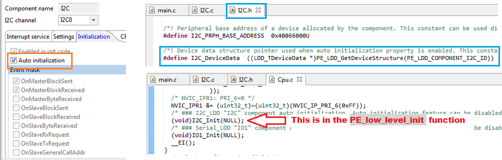

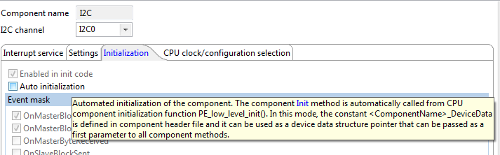

Q: If I were to select the "Auto Init" box, what is the component name?  does it remain the default name, or if I use the advanced properties to rename my I2C to "Accel" (for instance), would the device pointer become "Accel_DeviceData"  ??
A: If you select the Auto initialization the module will be initializated in the PE_low_level_init and a pointer to the component will be created in the .h file of the component; and every time you need to point to the component in any of it method you need to use this pointer. You can see this in the image below:
To select auto initialization or not will depend on your application for some reasons:
1. If you want to create your own pointer to the component then do not select auto initialization.
2. If you want or need to initializates the component in other part of your code that is not the PE_low_level_init function then do not select auto initialization.
Q: what are the ramifications to all this if I were to try to use polled mode, rather than interrupts?  How do you do the checking that the data has been TXd/RXd - just check the state of the buffers?  If that's the correct thinking, would I need to flush the buffers once the send/receive function has completed?
A: Here is where you have to say we are lucky to have Processor Expert on our side. You can check that if we do not check the Interrupt service box a new method is generated, this is the method Main. You can see this method has the complete sequence to handle the I2C protocol without interrupts.
I hope this information solve your queries.
Adrian
