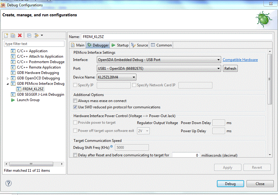

I just installed KDS 1.0.1 and attempting to connect to a FRDM-KL25Z.  Everything worked up until I try to connect with the debugger.  I have followed the QSG and tried both the P&E and MBED options.  Here is the OpenSDA example where it sees the USB1 port.

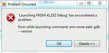

Here is the error
I watched the tutorial video and followed it exactly up until the first Debug launch.
Any idea what this error is indicating?  I am encouraged that KDS sees the debug hardware when I install it, but the error isn't giving me enough information to figure out where the problem is.

I had the same problem, but I didn't see a double semicolon in my PATH variable.  I had to put the line
C:\Freescale\KDS_1.0.1\toolchain\bin\arm-none-eabi-gdb.exe
in the executable line for the debugger GDB client settings.

it could be that you have a problem with your PATH variable on Windows (double ;; ?). See the release notes Kinetis Design Studio V1.0.1 Beta Release Notes and search for "--version".
