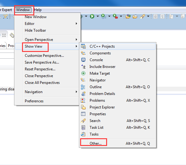

I'm trying to install Embsysregview per instruction in the following link
How to Add Register Details View in Eclipse | MCU on Eclipse
But for some reason keep getting the attached error (Cannot complete the request. This installation has not been configured properly for Software Updates.)
My software versions are the following
KDS Version: 3.2.0
Eclipse Version: Luna SR2 (4.4.2)
MCU: MKM34Z256XX5
Can anyone please help?
I am trying to view the peripheral resisters after flashing my MCU. If there is any other way to view the peripheral register values kindly share those details.
Thank you.

Hi Arvind,
the reason is KDS 3.2 already contains EmbSysRegView so it cannot be installed again.

Hello Arvind,
KDSv3.2 can directly view the peripheral resisters with out any hesitate .
You can find it as below steps:
Hope it helps
