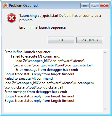

Hello every on, i am trying to debug a project using KDS and FDM-K64F. After setting the debug parameters without problem, i then lunch the debug processe. it started well to flash the controller till a point i got the following error:
Thanks for any solution proposition.

Hello Gides,
Which debugger do you used ? Please show the debug configure view .
Also first test one simple project .

Hello Alice,
thanks for your reply. i Actually use the GDB OpenOCD Debugger. Yes i did already tried with another siple project and it works fine without problem.
you can see the debug config:

Hello Gides,
You said use the same configure , one simple project can work well ,while another one can not ,
so the problem is your project, not the debugger configure .
So please send your project to me , while in general , if one project can download , the other ones
should be also ok .

gideshermann
Hello Alice,
thanks for your help. I can't send you my project for some reasons.
You are right. the problem should be with the project files. i will try check on.

Hello Gides,
-You can also submit a case to NXP support  that only yourself and the service and support personnel can
see i :
https://community.nxp.com/docs/DOC-329745
- And you also can test he other debug method -jlink or PE debug .
Hope it helps

gideshermann
Hello Alice,
thanks very much for your support.
The problem has actually been figured out and solved.
One problem was that i had two microcontrollers pluged in on my pc, so one had to be plugged out.
And the second was about the memory mappin in my linker file. it has to be adjusted.
Now i can freely debug.
