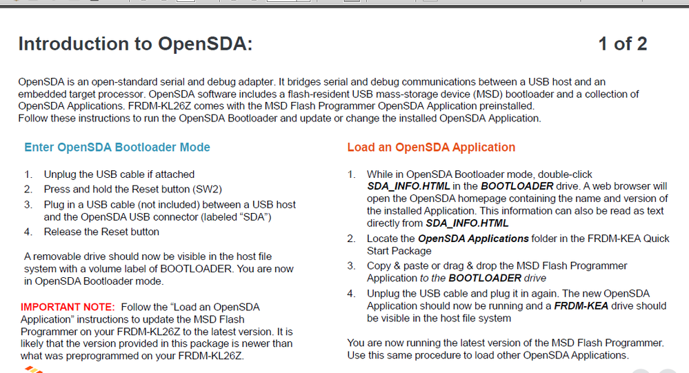

Hello Tom,
- Please refer to the quick start guide update the bootloader :
use the PE firmware "MSD-DEBUG-FRDMP-KEAZ128Q80_Pemicro_v118" , copy and past it into bootloader , i have
attached this file .

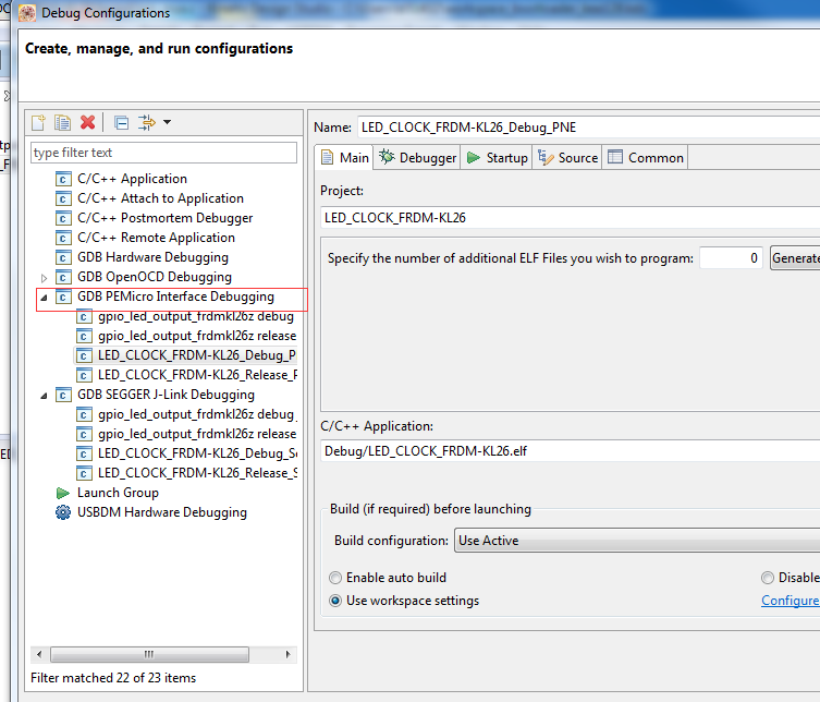

- Then when you use the KDS to download ,please select "GDB PEMicro Interface Debugging" :
Hope it helps

Thank you, Alice.  I had already installed that very driver and was attempting to debug a test program.  I was able to do basic debugging from the console.  I was able to build a simple blinky program, upload it, and run it.  It did not work as expected and I was attempting to find out what wasn't working.  It began throwing runtime exceptions.

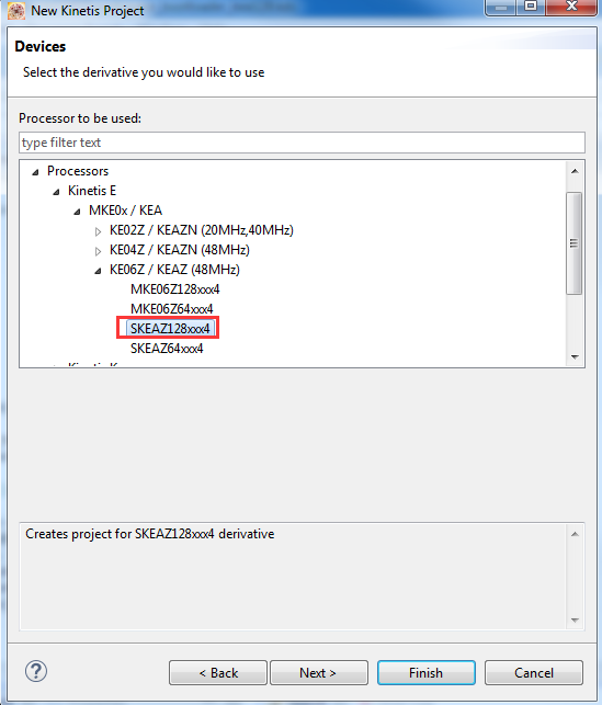

Hello Tom,
Yes, the two  libraries almost the same , when you create project please select "SKEAZ128xxx4"
Hope it helps
Alice

Wow!  I was using the wrong PE processor profile.  I'm lucky I did not brick the board.  I hadn't even seen that profile in the selection window.  I didn't scroll down that far.  Using that one did make the KDS IDE a little more of what I expected to see.  However, I'm still having some issues with getting things to work.
