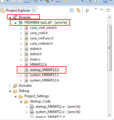

I've successfully created a project that started from a KDS export of mbed blinky for a FRDM-K64F!
Now it is time to cut the USB umbilical but a cold power on doesn't reset properly.  I have switched the reset selection jumper.  Sounds a whole lot like:
FRDM-K64F booting issue when powered from USB port
But... my KDS project has no .s files but it does have a startup_MK64F12.o.  Any ideas on the easiest way to tweak the EZPORT bit?

Hi Jon,
The  startrup_MK64F12.s file is here :
Alice

JonathanHess
I got my project as a KDS export from the mbed online compiler.  As such, It only had .o files.  I tried getting the source from:
     http://developer.mbed.org/users/mbed_official/code/mbed-src/export
I moved the existing mbed directory out of my project directory.  Moved the new source dump in.  Started up kds and told it to resync but now I'm having project issues.
Jonathan
