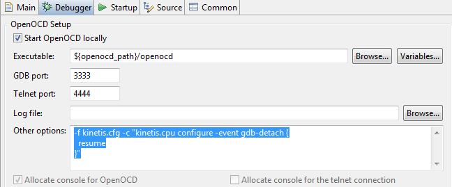

I have ran into what seems to be a bug in beta version, and I have not found any answers for that so far. When I am running debugger, if I click on "Disconnect" button, the debugger should disconnect and the program should keep running on target board. However, when I try to disconnect, the program halts. The debugger acts as if I had clicked the "Terminate" button.
I have tried that with a blinking LED program, using Processor Expert with a BitIO for the LED and a periodic interrupt timer. When I click on "Disconnect" the program halts. I have tried that with both a FRDM-KL25 board (P&E Multilink OpenSDA interface) or a FRDM-K64F (Segger J-Link interface).
Am I doing anything wrong? Or is this a real bug?

Hi Antonio,
if you are using OpenOCD with CMSIS-DAP, then I have a solution for you. Inside the debugger configuration, under 'Other options', use this:
-f kinetis.cfg -c "kinetis.cpu configure -event gdb-detach {
  resume

yes, this is a bug, we saw it already in the pre-beta, but somehow got missed for the release notes (is added now).
My understanding the bug is how the GDB server is handling the disconnect command. And it is different depending on which GDB server you are using:
- P&E and OpenOCD: they both stop the target, then they disconnect.
- Segger: it stops the target (but does not disconnect)
Correct would be to disconnect while the target is still running.
I have filed corresponding tickets to P&E, Segger, so hopefully this can be addressed for the V1.1 GA (General Availability) release.
Thanks for reporting!
Erich

quevedo
Contributor V
Hello Erich,
I have tried this option with my FRDM-K64 board, with a blinking LED program. When I tried to debug, I got this message on Console:
Quit (expect signal SIGINT when the program is resumed)
Exception condition detected on fd 0
error detected on stdin
What can be going wrong?

BlackNight
Hi Antonio,
Does it show this?
So yes, I have this too (mostly for the first debug session after starting Eclipse). I'm not sure why. But what helped me so far is then to unplug the board and plug it in again. Can you try this?
Erich

marcotiberio
Dear Erich and Antonio,
I have almost the same problem debugging my FRDM-K64F with OpenOCD.
The debugger won' t start and to the console I have the same messagge:
I have already debugged many many times before, but all at once I am no longer able to debug my projects, even those who work before...
I have already tried your solutions but it has not solved my problem.
Thanks in avance for your replies.

BlackNight
Which mbed/CMSIS-DAP firmware are you using on the FRDM-K64F? The latest (0203) from Firmware FRDM K64F - Handbook | mbed?
6,695 Views
BlackNight
On another thought: is the red reset LED on (or nearly always on)?
You might try to load the attached .bin file with the mbed bootloader to recover the device.
Additional recovery methods are described in http://mcuoneclipse.com/2014/04/19/recovering-frdm-k64f-mbed-board/
I hope this helps,
Erich
6,695 Views
marcotiberio
Hi Erich,
thank you for responding so quickly.
Yeah! I have loaded the .bin file and I have recovered the board. Now I am able again to debug my projects!
Thank you very much.
