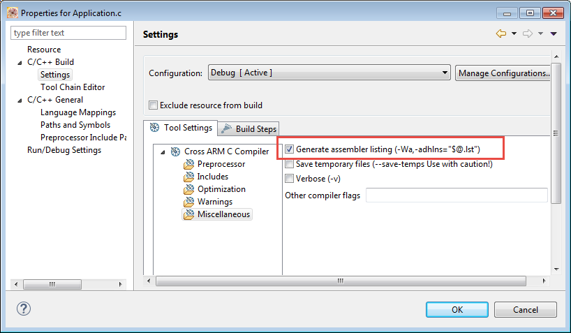

I can disassemble an elf file in CW10 by right clicking it and choosing disassemble.  That option isn't in KDS3.  Is there a way to do it in KDS3?

I also found I can just go to Project|Properties|C/C++Build|Settings|Toolchains and set the Create Extended Listing box.  Then an option will appear in the Tool Settings allowing one to easily choose what is shown in the listing.

Hi Michael,
no, there is no such context menu in stock Eclipse Luna and CDT (which is what KDS v3.0.0 is using). But you can use 'per-file' options:

Hi Erich,
Although the *.lst files help, they don't show all the code generated and where it is located.  To get a full listing, I added the following command
arm-none-eabi-objdump -d -S ${ProjName}.elf >>${ProjName}.txt
to the Project|Properties|C/C++Build|Settings|BuildSteps PostBuildSteps command box.  The resulting .txt file shows up in the Debug directory of the project.
