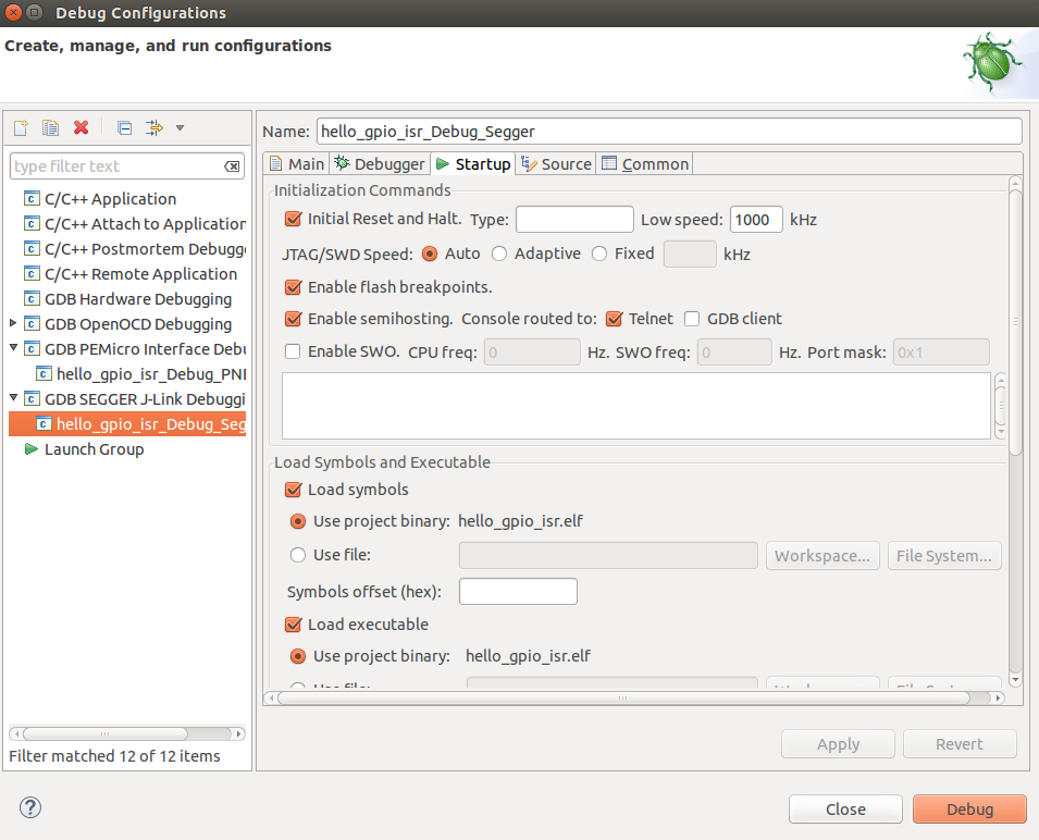

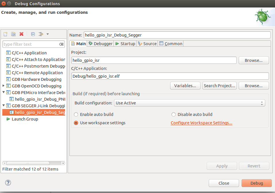

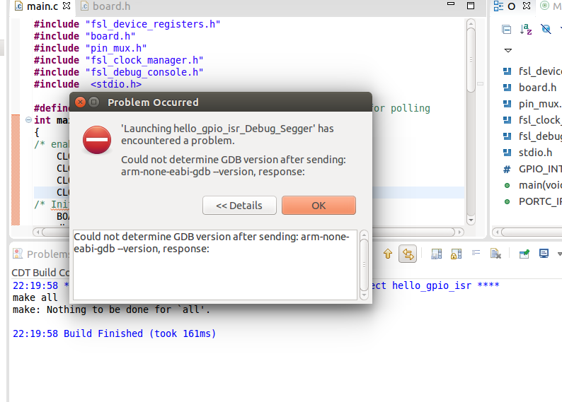

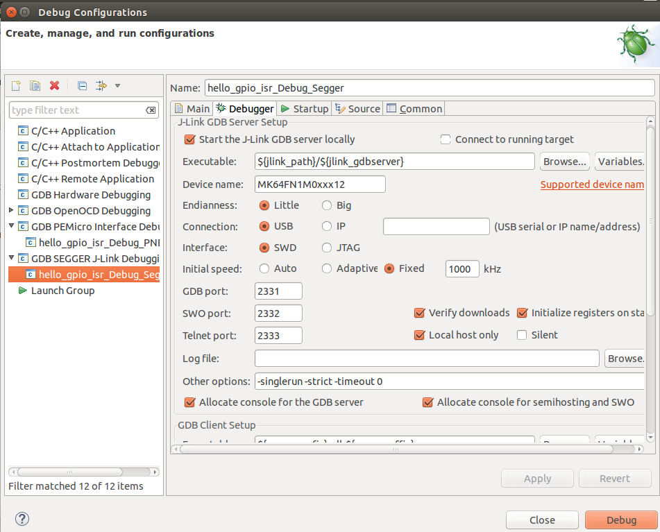

I have just installed Kinetis 3.0.0 and the SDK 1.2 for the FRDM k64F platform on Ubuntu 14. I am trying to debug my application with Segger J-link, but I got the following error: "Could not determine GDB version after sending: arm-none-eabi-gdb --version, response: ".
I think that this problem is due to some error in the Kinetis configuration, but I am not sure.
By the way, I am using (JLink_OpenSDA_V2_2015-06-11.bin) for debugging.
I have followed the instructions for debugging such as in this tutorial: GDB Debugging with Kinetis Design Studio
I attach images about my current configuration:
Could anybody be so kind to suggest an approach to fix this ? I'd appreciate it a lot
Thanks in advance.

Problems running "arm-none-eabi-gdb --version" can arise if the IDE is unable to locate/execute the GDB client. A few things you could try:
* Run /opt/Freescale/KDS_3.0.0/toolchain/bin/arm-none-eabi-gdb from the command line. The toolchain in KDS 3.0.0 is built for 32 bit systems, if you're on a 64-bit system you may need to install additional support packages (lib32z1 lib32ncurses5 lib32bz2-1.0 Toolchain install | GNU ARM Eclipse ).
* If you are able to run arm-none-eabi-gdb then perhaps the PATH used by the IDE is unable to find it. On the debugger tab of your debug configuration, try specifying the full path to the GDB client.

Hi Joe,
Thanks a lot for the hint. I am working on 64bit arch, and I needed that library. After installing it, I could debug with J-Link.

I'm also on Ubuntu and KDS 3.0. I checked your screenshots against my working configuration. The only difference I found was on my Startup page I have the Enable SWO box checked. My cpu and swo frequencies are both set to zero and the portmask is 0x1. Hope this helps!
