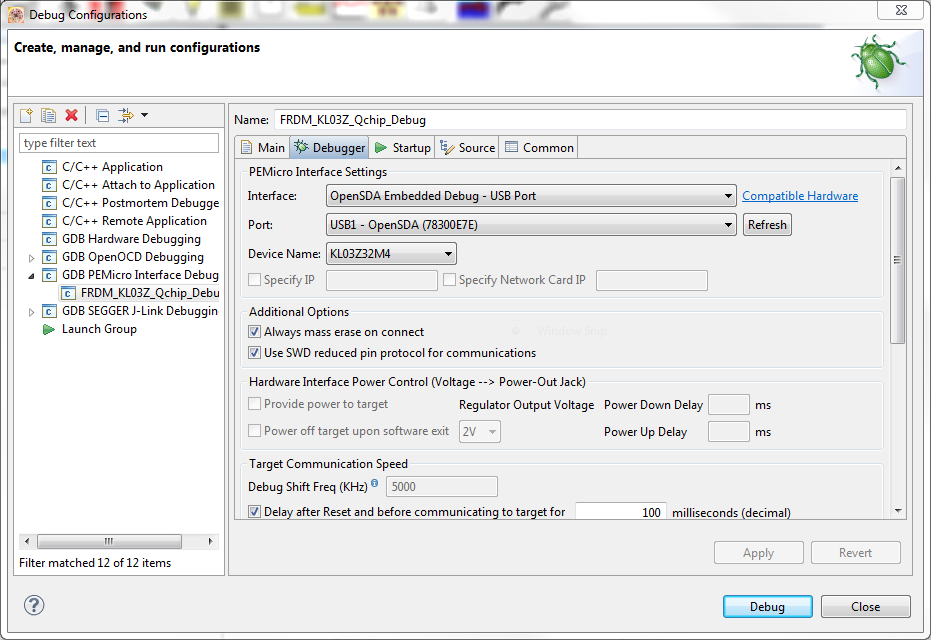

I keep getting erratic debugger behavior. Sometimes it works, sometimes it does not.
I regularly get the folowing error: "Error setting BP @xxxx" and "Error removing BP @xxxx".
xxxx is a hex number.
Regularly but less frequent it simply can't connect to the target.
It is a real nuisance because when it happens I have have to restart KDS, clean the project, rebuild and try it again.
Doe anyone have any suggestions as to what I could do to correct this ( setting, config, ? )
My setup is like this:
     - KDS 2.0.0 with additional tools to support KL03Z processor (toolchain etc...)
     - FRDM-KL03Z board.
     - The debug configuration uses the "OpenSDA Embedded debug - USB port" interface.
I have noticed the "Debug shift frequency" is set at 5000 Khz and cannot be changed. The associated comment says it should be set at +/- 1/6th of the target clock rate.
maybe that has something to do with it because I know the board starts at 8 Mhz. I have to change the settings to make it work at the 48 Mhz i need.

Hi Filip,
I suggest you update the firmware with MSD-DEBUG-FRDM-KL03Z_Pemicro_v114.SDA. then reset board and test connection again.
http://cache.freescale.com/files/32bit/software/board_support_packages/FRDM-KL03-QSP.zip
with MSD-DEBUG-FRDM-KL03Z_Pemicro_v114.SDA, I can connect board every time.
attached is my config setting.
