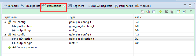

Hi  Michael,
I just want to know detail what information you want to see.
Usually we check variable on ''Expressions " view of KDS you also mentioned :
If you want to check variable when the program on board is running, you can refer to this thread :
Automatic Variable, Expression and Memory Display with GDB and Eclipse | MCU on Eclipse
