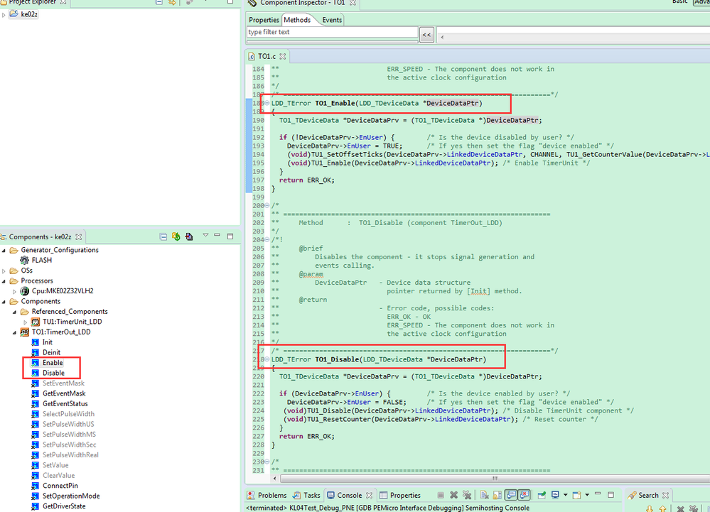

Hi Robert,

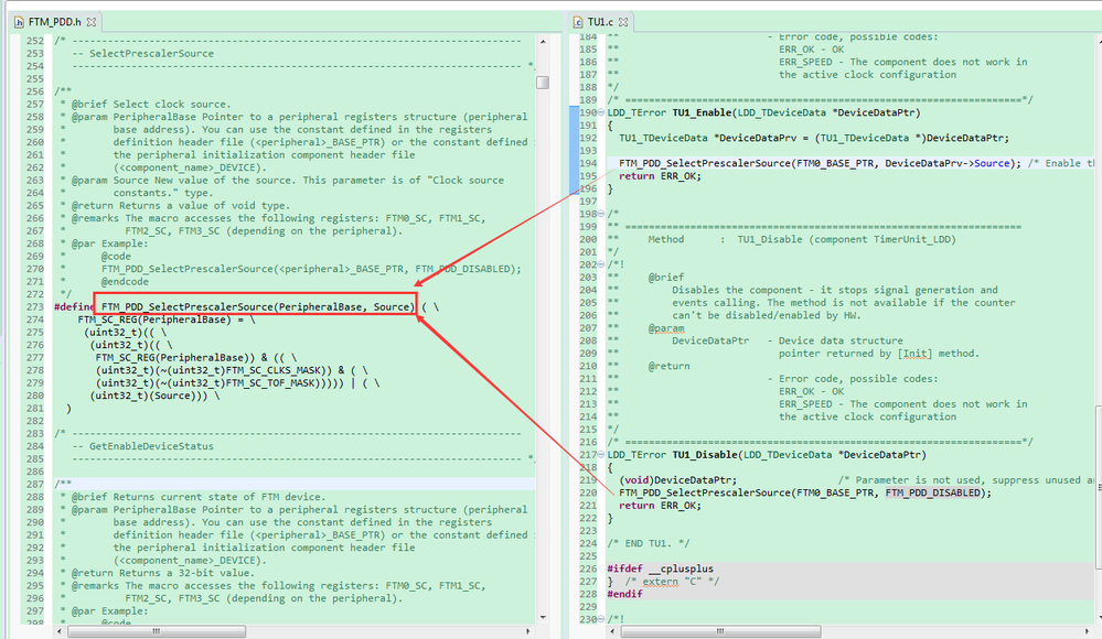

Does the function of "Enable()" and "Disable()" can meet your requirement ?
Hope it helps

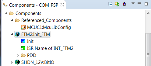

rpflaum
2017-08-21 08_29_24-Processor Expert - COM_PSP_Generated_Code_WAIT1.c - Kinetis Design Studio - C__U.png
I have instantiated a FTM2 component. I do not see a Timer under Referenced_Components only a MCULibConfig therefor the functions you mention do not present themselves as available.

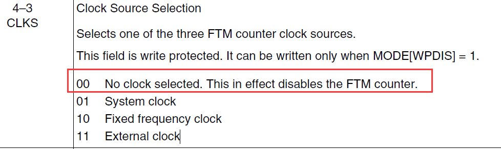

Hello Robert,
You can also write disable/enable code by yourself , it just configure the register of :FTMx_SC
The two functions I mentioned also only configure this register:
Hope it helps
