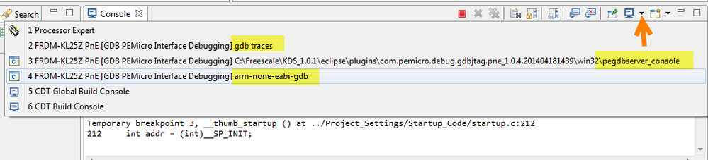

To further investigate this, could you post a screenshot of your breakpoints (if you still are able to see the issue)?
Additionally, the console view contains three dedicated logs for gdb traces, the gdb server and the ARM gdb:
They should contain information what is going on. Could you post the logs?

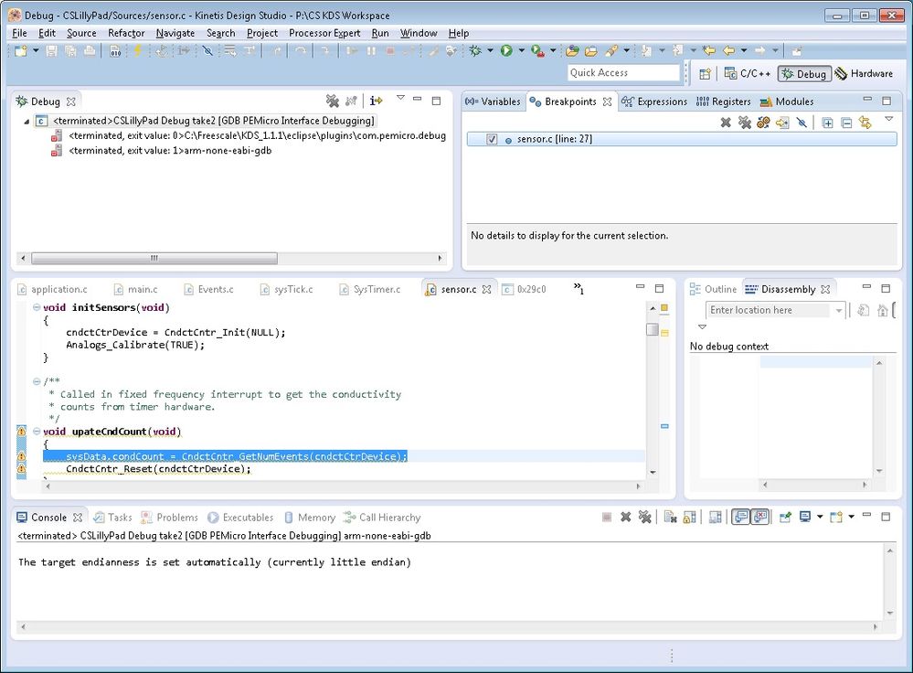

claybarclay
Hello Erich,
  Below is the information you asked for.  I suspect that this could be happening because the debugger thinks the function is associated with real program op codes in memory.  But it seems that for some reason this function has been left out of the binary.  It is called on place in the code and I think the compiler may have marked the function as unreachable.
Here is the code where it is called:
void sysTick_OnInterrupt(LDD_TUserData *UserDataPtr)
    // For now only need to increment system time here
    sysData.systime++;
    // Get the count
    if (sysData.systime & 0x01FF == 1)  // Count for 512 msecs
        upateCndCount();

14,953 Views
BlackNight
I think you wanted to write
if ((sysData.systime & 0x01FF) == 1)  // Count for 512 msecs
Erich

claybarclay
Erich,  Yeah I found that one so I know why the code was unreachable, but that just gets me back to the issue at hand.  Why does this tool allow breakpoints set on unreachable code to cause the debugger to fail without any warning.  CodeWarrior would let you know if the requested breakpoint was not reachable and effectively disable it.  I guess now that I know about this bug I am going to be ok by working around it, but I warn my fellow developers out there about this strange failure mode in KDS 1.1.1  And if you hear about a fix please let me know.
  thanks

BlackNight
Clay,
without a doubt, this is not how gdb should deal with this. I tried to reproduce it on my end, but I was not able to. Not sure what specifics are behind it making it fail.
Erich

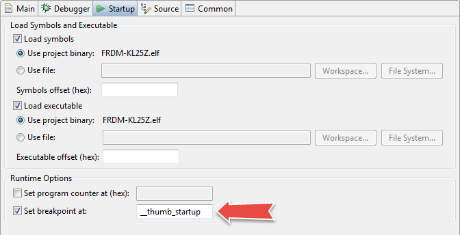

Few ideas:
- does your application change/remap the debug pins? If your application cuts of the debug pins, then the debugger will loose connection.
  Check if you have not used debug/SWD pins for your application.
- don't run to main(). Instead, set a breakpoint for your startup code:
I assume that you will be able to step through your startup code, and then you should be able to see what is causing the problem.
- check the various console output and log for debugging:
There might be a hint in it what is causing this.
