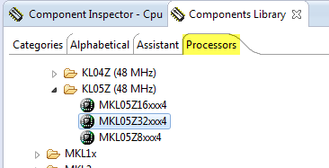

I have  project on a KL05Z8 and want to move to a larger memory version such as the MKL05Z32.  There doesn't seem to be a simple way to do this.  PE lets you change package types, but not memory sizes.  Am I missing something?  I suppose I could just edit the ROM/RAM areas in the CPU component inspector, but that seems inelegant.

Hello LI_Dave:
You can add the processor from Components Library -> Processors:

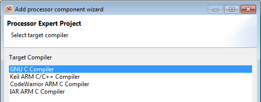

The wizard will prompt you to select the package.
:smileyalert: The wizard will also ask you about the compiler. Make sure that GNU C Compiler is selected, since it is the one used by KDS.

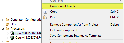

:smileyinfo: The drawback is that you need to replicate the CPU settings in this new component.
You can choose to remove the previous CPU or leave it so you can jump back to that one if you wish using the context menu -> Component Enabled:

Jorge,
Thanks for the quick reply, and sorry for the double post.  I assumed incorrectly that I did something wrong on the first one.
That solution looks good.  It would be really helpful in the future if it were a little easier to move between memory sizes.  Having to manually re-enter the PE config information is time consuming and could result in errors.
Feel free to delete the other duplicate thread.
