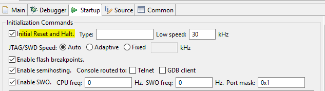

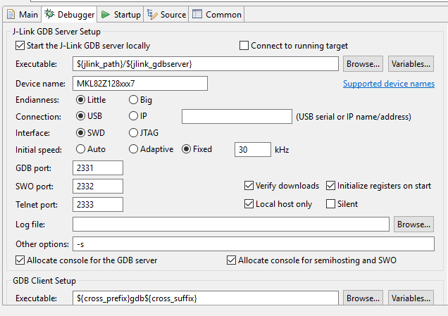

- I launch the debug with the following configuration.
And when the debug perpective open, the program is already running ( I dont have to press startand the program is supposed to start as halted)
If I pause the program is always in this state:
Any ideas why?

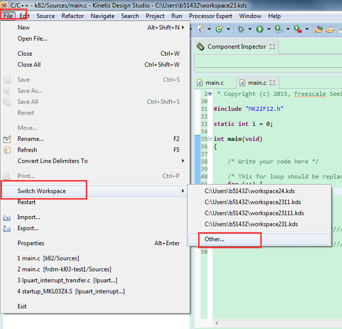

Hi!
I have just found a solution. I checked the breakpoint at main and it was already set, I tried switching workspace but the debugger keeps faulting. The solution was to start the debugging: It will start in the same status as stated in the first post (with a hard fault) but, if I press the reset button while in that state, the debug start working as normal. I show it in pictures for anyone that has my same problem.

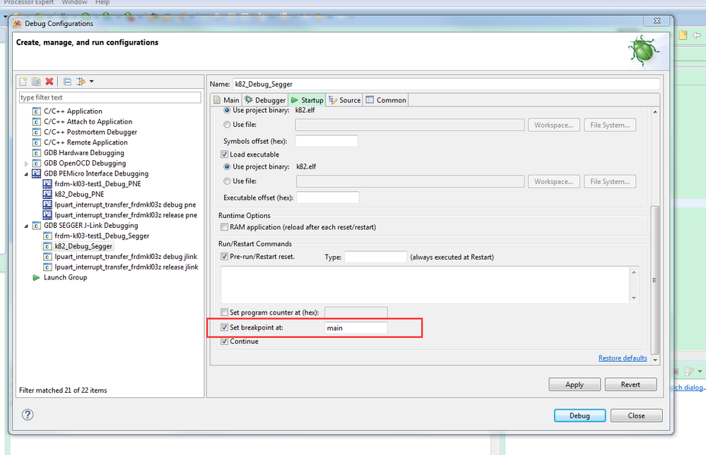

Hello Angel,
- Have you set breakpoint at main :
- Please try to switch another new workspace to have a try, or test another project.
Hope it helps

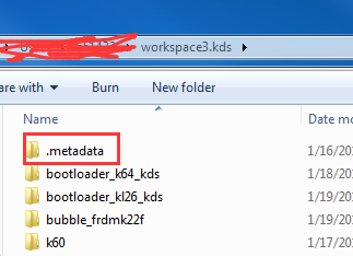

Hello Angel,
- If you worry about the project flashed impacting the new project, please
erase the flash use j-link commander (can download at to https://www.segger.com  ), and
see the attached video created by my colleague .
- Yes, if download many times, it maybe occur some problem, you can also delete the .metadata folder under
workspace :
Alice
