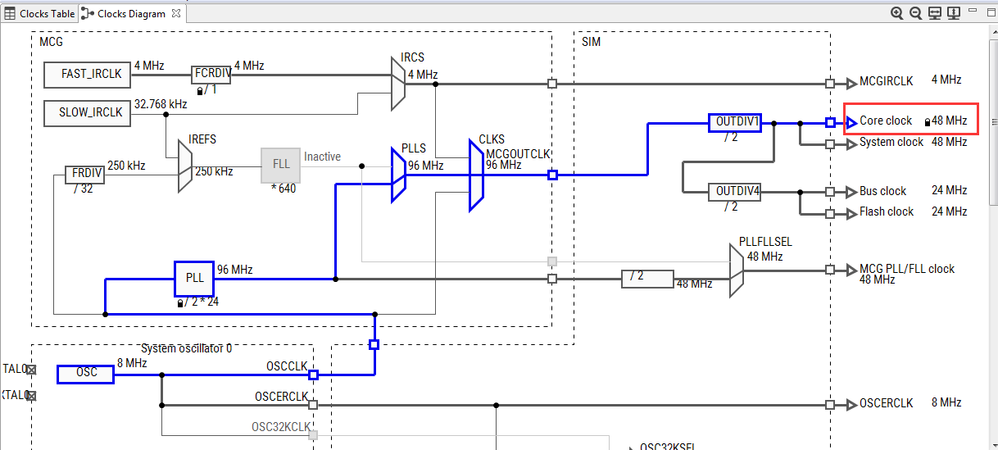

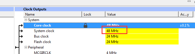

Hello Chris,
- The clock configuration is a  too that directly configure the clock , then generate clock_config.c and  .h files.
add the two files into your KSDK project directly .
For example , if we want use 48M core clock , we can directly set core clock to 48M:
From the CLocks Diagram we can see the detail about  how to generate the 48M core clock :
- About the clock part , I recommend you refer to the Clocking diagram of Reference Manual of your chip
to analysis : ( below is the clock diagram for k40, please find the right one for your chip)
Alice
