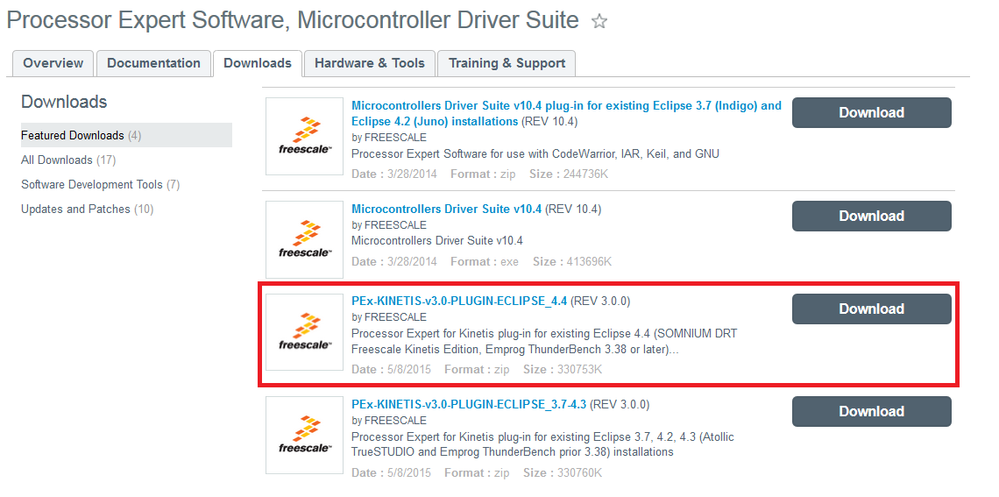

The LPCxpresso IDE is based on Eclipse Platform v4.4.2. Therefore I have downloaded and installed the
PEx-KINETIS-v3.0-PLUGIN-ECLIPSE_4.4 (REV 3.0.0) (see the page Processor Expert Software, Microcontroller Dr|Freescale):
The package contains freescale_updater.zip and PEx_for_Kinetis_3.0.0.zip. You need to install the Freescale updater firstly.

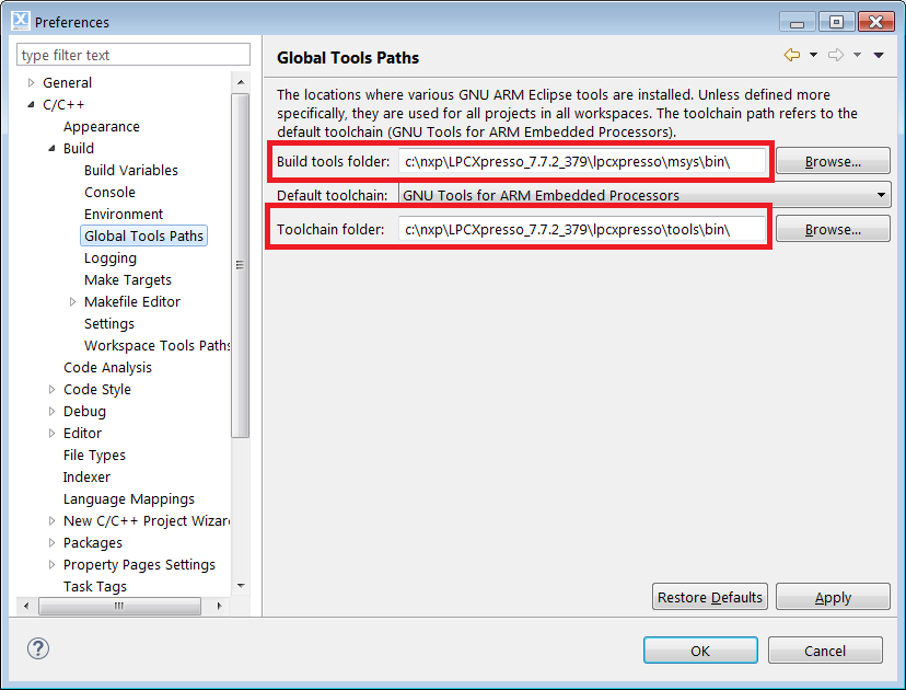

When I have set following Global Tool Path in Window > Preferences (see the screenshot below) I have been able to build the default project.

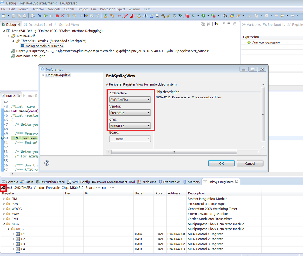

The default LPCxpress installation does not contains any data about Freescale Kinetis derivatives. Therefore there is not possible to see any registers in the Debug perspective. You can install the EmbSysRegView plugins that are available at the http://embsysregview.sourceforge.net/update  site (use the Help > Install New Software... command).
When you start debugging, open the EmbSys Registers window (navigate to Window > Show View > Other and select the EmbSys Registers). In the EmbSys Registers window select SVD(CMSIS) architecture, Freescale vendor and the target Chip), see the screenshot below:
