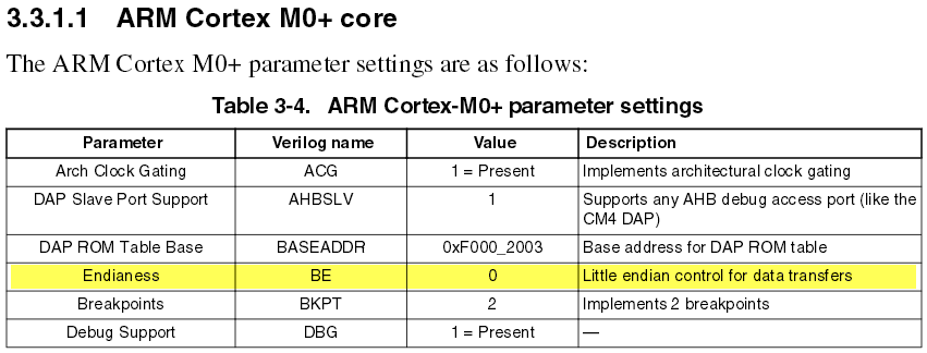

I'm using KL16Z256VLH device and am having trouble converting it to big endian formatting. When I change the Target Processor Setting from  Toolchain Default to Big Endian, I get errors during compilation.

Hello Ray Breslau:
Unfortunately the KL16Z256VLH device only supports the little endian format, as noted in the manual:
However I checked the Kinetis Design Studio IDE and I think it should not let you select the Big Endian option if it is not supported. I will provide this feedback to the developers.
I hope this clarifies the issue.

In Eclipse you can select how the data is displayed (see A little or big Indian? A Plea for Peace… | MCU on Eclipse ). However, the ARM cores for Kinetis as implemented by NXP do not allow you to switch between little and big endian. The compiler and tool chain are universal and could support either format, if supported in the silicon. I think the error you saw was with linking the binaries, as the LE/BE is encoded/listed in the libraries. So you would have to have the matching libraries. But as Kinetis does not support BE, I think this is anyway not relevant.
