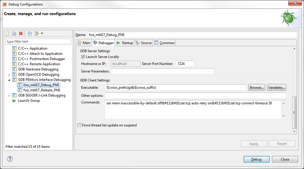

dmarks_ls
Senior Contributor II
For what it's worth, we had some inconsistent results as well with our initial Rev. A Multilink Universal pods (non-FX).  We RMA'ed one of them and got a Rev. B in exchange; we have two or three Rev. B pods floating around, and they've been pretty stable.  I think the other Rev. A unit crapped out at some point.
Definitely contact P&E Support, they may be able to RMA your Rev. A pod and exchange it for a newer revision.
As for your original issue with the "Configuring GDB Aborting Configuring GDB" message, that's a bug in how KDS/KSDK generates the launch configuration files.  See this thread and my screen captures here: KDS3.1 GDB 94% blocking
6,372 Views
richardfox75
Where is the debug configuration \debugger\GDB client settings?
Dick Fox
Firmware Engineer
NATIONAL CONTROLS CORPORATION BUSINESS UNIT
INSTRUMENTATION AND SPECIALTY CONTROLS DIVISION
1725 Western Dr | West Chicago, IL 60185 | http://www.ametekncc.com
Phone: (630)621-3118 | email: Dick [email protected]
6,372 Views
dmarks_ls
Sorry for the delay; I hate how the forum doesn't send direct notifications by default.

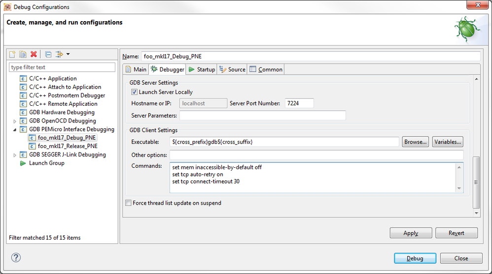

Either click the Run menu heading, or find the green bug toolbar icon and click the down arrow.  Then pick "Debug Configurations..."  After a few seconds, the dialog opens.  In the left pane, select and highlight the debug configuration you want to run.  In the right pane, select the Debugger tab, then scroll down all the way to the bottom.  There should be a GDB Client Settings area, and a large text box labeled "Commands".  When you first create a KSDK 2.0 project, the commands can look like this:
That
 stuff is badly escaped end-of-lines.  Just delete them and put in proper line breaks, like this:
That will eliminate the "Aborting configuring GDB" error for a brand-new project.
