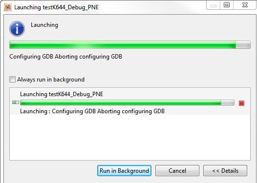

KDS3.1 GDB 94% blocking
10,251 Views
PO220
I'm using a FRDM K64 board with PE multilink universal (the green one)
With CW10.6, all is working well.
With KDS3.1 an a new project KSDK2.0, I can not debug the target.
I choose GDB PEMicro Interface Debugging -> MyProj_Debug_PNE
Then the pegdbserver_console.exe process start and...blocking at 94%
no alarm.
If I cancel the process nothing appens ; it remains grayed

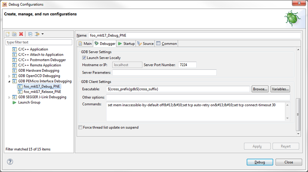

I've been struggling with the same issue for the past week and found the root cause:
When the Kinetis SDK 2.x Project Wizard creates a new project, it generates launch configuration files which contain the following entry:
<stringAttribute key="com.pemicro.debug.gdbjtag.pne.gdbClientOtherCommands" value="set mem inaccessible-by-default off&amp;#13;&amp;#10;set tcp auto-retry on&amp;#13;&amp;#10;set tcp connect-timeout 30"/>
However, the value field should be:
<stringAttribute key="com.pemicro.debug.gdbjtag.pne.gdbClientOtherCommands" value="set mem inaccessible-by-default off&#13;&#10;set tcp auto-retry on&#13;&#10;set tcp connect-timeout 30"/>
If you compare the two strings, you'll see that the wizard has taken the '&' of the numeric character reference and re-encoded it as a character entity reference. Eclipse decodes the character entity when it reads in the configuration file, but the result is the numeric character reference is not decoded. When the command string containing these numeric references is passed to pegdbserver, it crashes.
So there are two bugs at play here:
1. The KSDK Project Wizard is generating launch files with invalid strings.
2. The pegdbserver doesn't handle unexpected input gracefully.
As others have noted, the workaround is to go to the Debugger tab of the "Debug Configurations..." dialog and edit the Command string to replace the numeric references with a newline.

PO220
No explication but solution :
In debug configuration/ debugger/GDB Client settings
A have by default
whith
it's working now !

dmarks_ls
Senior Contributor II
Erich, unless there's a P&E component generating the launch files when the project is created, this is primarily an NXP bug.
I don't know whether this is ultimately a KDS or KSDK issue, but it is a bug in your software.  The problem is that dot-launch files are being created with invalid debugger command strings, and this is compounded by the fact that the GDB server hangs when given these strings, and KDS hangs as well.

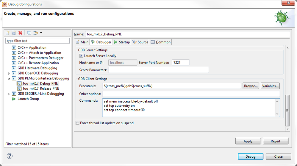

I'm using KDS 3.1, with a Kinetis Expert KSDK 2.0 build for the MKL17Z128.  I made a brand new KSDK 2.x project, didn't even build it, and opened the launch configuration.  Here's what it looks like as created by KDS/KSDK:
Look at the GDB Client Settings / Commands field.  Whatever tool or component is generating the launch file, isn't escaping CR-LF correctly, and they're being put in there as literal escaped characters.  Now here's all I have to do to make this launch configuration work:
The solution is exactly as PO220 explained; just replace the badly escaped CR-LF pairs with actual newlines, and the launch configuration works.  This can be done in KDS as shown above; it's not necessary to use a text editor on the raw launch file.
I'm not sure how NXP didn't catch this during testing prior to release of the tools.  Please fix this in the next release of your tools; this burned an hour of my time, and I suspect it's burning dozens of other engineers' hours as they try to work around this, and eventually find this forum post.

PO220
It's exactly the same with OpenSDA !
bootloader mode
pemicro bin here P&E Microcomputer Systems: Over 30 years as an Industry leader in Embedded Systems Development Tools...
change selected interface in debug configuration
GDB blocked at 94%....
reboot -> same

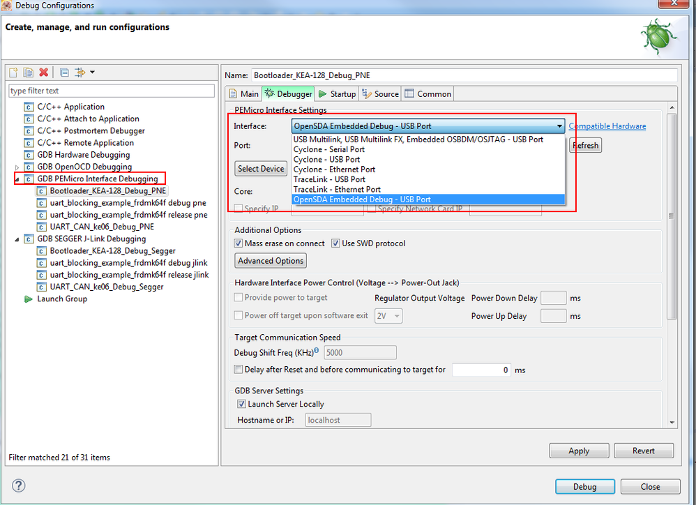

Hello David,
- Please check the debug configuration , which interface do you select :
- Could you please try the OpenSDA (j26) port to download,check whether it can work well ?
About use this method , please first copy and paste the file of "JLink_OpenSDA_V2.bin" to the bootloader mode,
refer to the RM of  ""FRDM-K64F Freedom Development Platform -Quick Start Guide.pdf"
