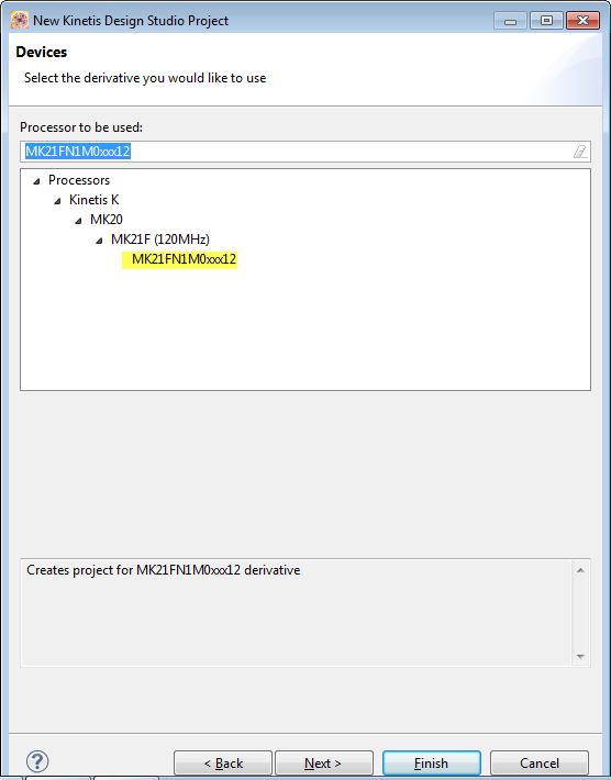

I see on the Code Warrior web site that only Kinetis Design Studio will support the new device in the Kinetis K series MCUs.
But are there plans for Kinetis Design Sudio to also support the legacy parts, such as the K21P121M120FS5 device that is featured on the TWR-K21F120M devkit?
Right now the situation seems to be that new devices are only supported by KDS, and legacy devices are only supported by Code Warrior. But neither tool supports the whole line.

The new Kinetis devices are supported by KDS and most of the legacy devices are supported as well. CodeWarrior will not support new devices.
If you are referring to this Tower board Kinetis K21 120 MHz Tower System Module|Freescale this one has on board a MK21FN1M0VMC12 device that is supported by KDS v1.1.1, you can find it in the New project wizard with the label MK21FN1M0xxx12.

adriancano
KDS is the tool used to develop with Kinetis devices, just Kinetis microcontrollers are and will be supported by KDS. CodeWarrior will still supporting other architectures as 8-bits, 16-bits and other No-Kinetis devices.
