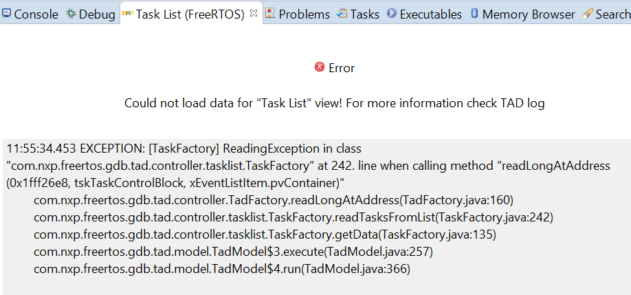

Trying to use the FreeRTOS task viewer shows the following error for ~one second and then KDS switches to a different tab:
The TAD log shows:

11:30:20.866 EXCEPTION: [TaskFactory] ReadingException in class "com.nxp.freertos.gdb.tad.controller.tasklist.TaskFactory" at 242. line when calling method "readLongAtAddress(0x1fff26e8, tskTaskControlBlock, xEventListItem.pvContainer)"

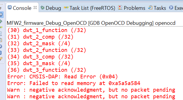

OpenOCD window seems to show reading a bad pointer?

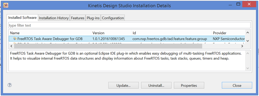

Here's the FreeRTOS plugin installation detail:

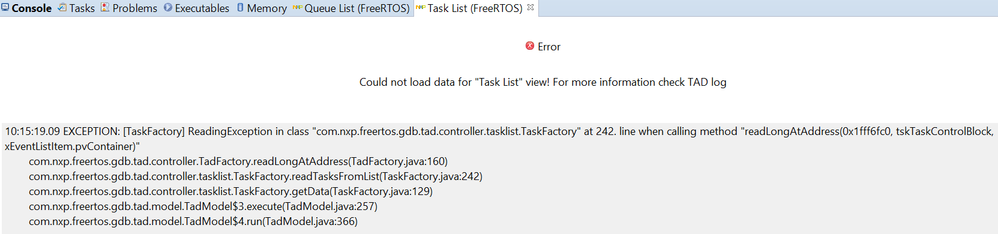

Another slightly different crash:

Footnote: I switched to a Segger JLink debugger as the Freescale/NXP-supplied OpenOCD/SDA combo was too buggy and slow for production work (JLink is enormously faster: loads and starting debug have gone from many seconds to virtually instantaneous). The FreeRTOS viewer works fine with the Segger JLink.
So, the bug is would appear to be (yet another) problem with the OpenOCD/SDA combo.
