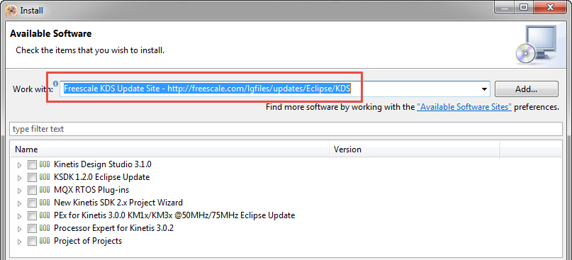

Installing Kinetis SDK v2.0 New Project Wizard in Kinetis Design Studio
  1. Start Kinetis Design Studio
  2. Select Menu Help > Install New Software
  3. Select KDS Update site (Freescale KDS Update Site - http://freescale.com/lgfiles/updates/Eclipse/KDS)
  5. Install the New Kinetis SDK 2.x Project Wizard
See attached video 'Installing KSDK v2.0 Project Wizard in KDS.wmv'

Hi Erich,
If I am following the instructions of:
This step is unclear:
Where is KDS Update site?  I am in the Available Software screen.
Neil
Update,
Ok it seems I had already done this step.

Where can i find the "New Kinetis SDK 2.x Project Wizard". I can not open the web " http://freescale.com/lgfiles/updates/Eclipse/KDS"
Hi Robin,
that URL is an Eclipse update site, not a normal web site.
See section above:
or section "‘New Project Wizard’ with SDK v2.0 and Kinetis Design Studio"
in https://mcuoneclipse.com/2016/01/29/first-nxp-kinetis-sdk-release-sdk-v2-0-with-on-demand-package-bu...
I hope this helps,
Erich
