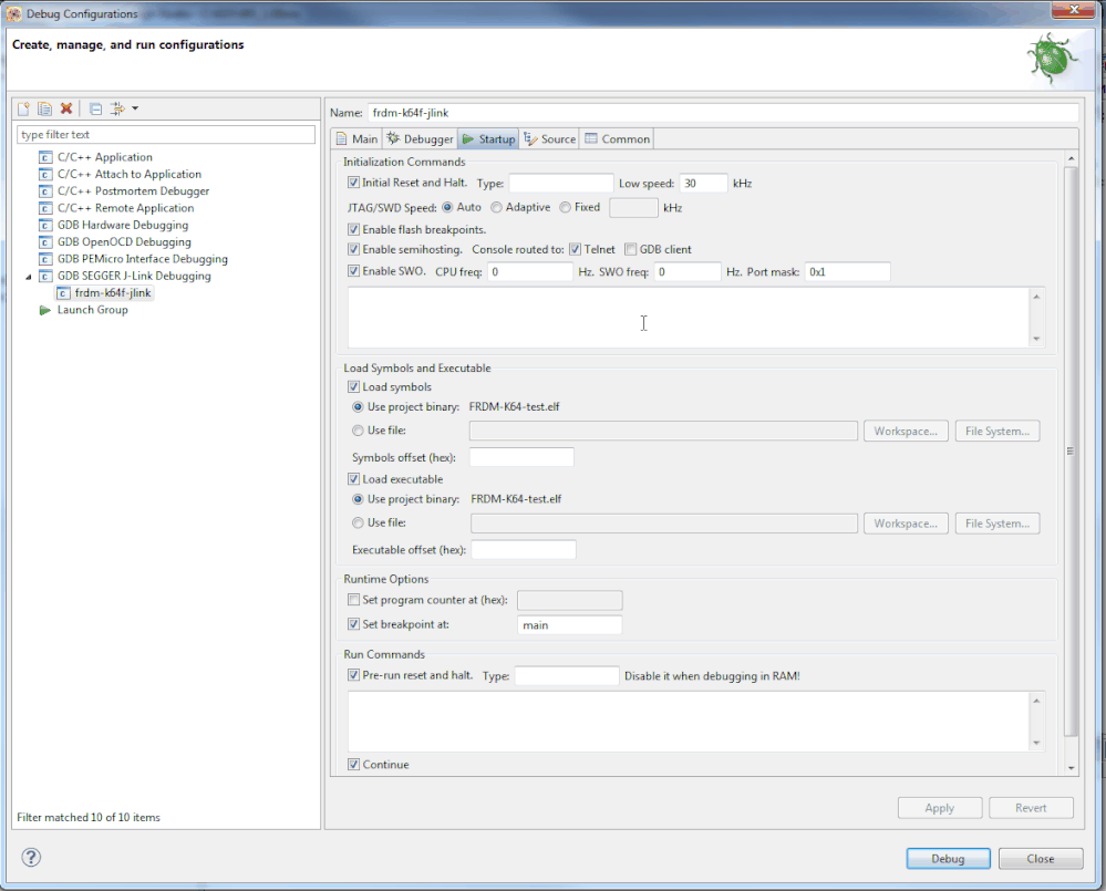

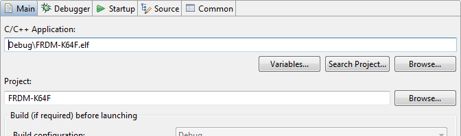

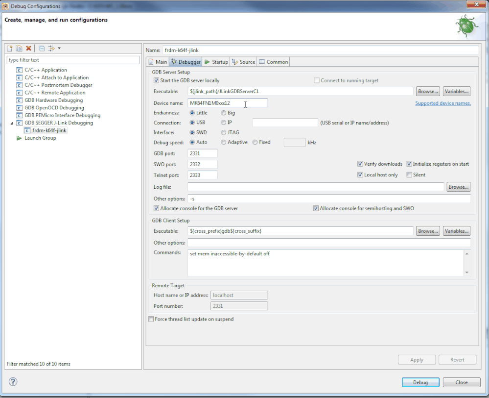

Below are pictures of my KDS "Debug Configurations" :
Be sure to click "Apply" then "Debug".
Hopefully that gets you going.

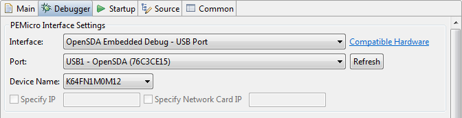

Hi everyone, I'm trying to get the P&E Micro OpenSDAv2 firmware working with my FRDM-K64F.  I added a new GDB PEMicro debugging interface and specified the .elf file.  In the Debugger tab, I also need to select a device name, but the closest thing is K64FN1M0M12, but the FRDM-K64F has the K64FN1M0VLL12.  How can I get my specific processor in the Device Name list?  Thanks!
I tried to set the M12, but then get these errors when I try to debug:
Error in final launch sequence
Failed to execute MI command:
-target-select remote 127.0.0.1:7224
Error message from debugger back end:
127.0.0.1:7224: The system tried to join a drive to a directory on a joined drive.
Perhaps I have other issues, for some reason nothing is actually building:
12:59:25 **** Incremental Build of configuration Debug for project KDS_MQX_proj_01 ****
make all
make: Nothing to be done for `all'.
12:59:26 Build Finished (took 681ms)
I know I've seen this before, but can't remember how I resolved it.
Hi dave408,
the K64FN1M0M12 is the correct device selected. The VLL information is not necessary as this denotes the package, and this is not relevant for the debug connection.
Make sure you have the correct settings specified:
Just to check: have you properly loaded the P&E firmware on the board?
I hope this helps,
Erich
Thanks, Erich, I'm an idiot.  I selected the first P&E interface and didn't select OpenSDA.  It's working now, thank you!
