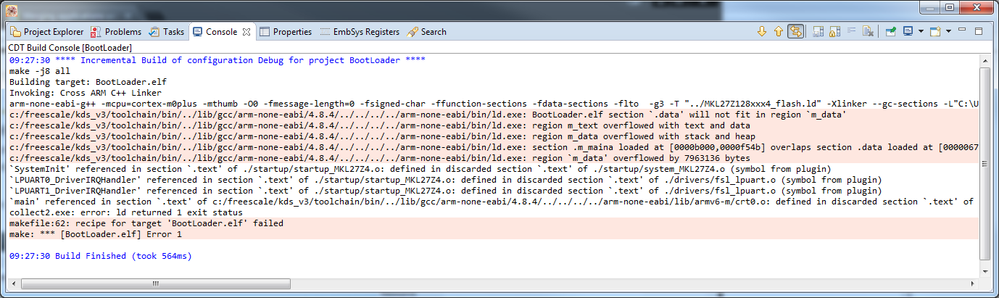

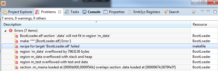

Hi Guys,
Thanks heaps for documentation.
I have an issue with doing this on KDS V3. When I add this to the linker is the step where it causes the errors:
m_data (RW) : ORIGIN = 0x1FFFE000, LENGTH = 0x00008000
/*ADDING THIS CAUSES THE ERRORS */
TARGET(binary) /* specify the file format of binary file */
INPUT (T7_000.bin) /* provide the file name */
OUTPUT_FORMAT(default) /* restore the out file format */
/* Define output sections */
SECTIONS
Where T7_000.bin is my application,  I get the following errors
My application is small, but some how its overflowed by 7963136 bytes?
The binary file is with my source, and linker knows to search source (if i remove it it tells me it cant find it)... The file size is small... i have no idea what its doing, and I cant find the documentation on the linker
I can share the source files, unable to attach in here, email me at [email protected]
Ive just followed the document again from scratch with every step and have the same issue, seem there is an issue with it seeing it as a raw binary file.
Can anyone help? something must have changed because I cannot get the linker to include the binary correctly.. I have found the linker documents but it appears you have to be an expert in the linker scripting to work out how anything works and there is no other example I can see of how to get the linker to put my binary file in...

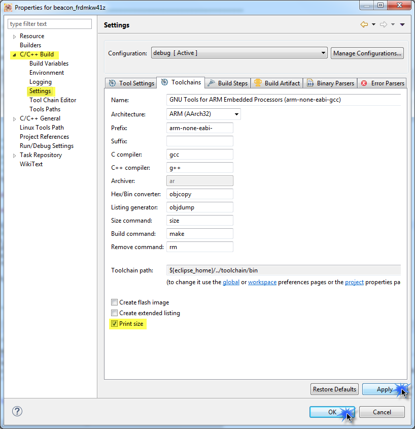

Hello Carl,
That is a strange issue, could you share the linker files for both the bootloader and the application? Also, could you enable the Print Size option for the T7_000 application and post the information?
Thanks in advance!
Carlos Mendoza
Hi Carlos, thank you for taking the time to reply.
I enabled print size (it was already on)
09:39:59 **** Build of configuration Debug for project Appplication2 ****

So does anyone know why this example stopped working? I can email the entire projects to someone, ive copied it line by line...

3. Add a post-build step to the application project to call a merge utility (all IDEs allow this and in KDS just add a bat file to its post-build step) which will be executed each time the application is built.
Since default build settings are not used, post build option is not coming in settings menu.
Can you provide detailed procedure for this, how to add post-build step for above case.
Aniket
